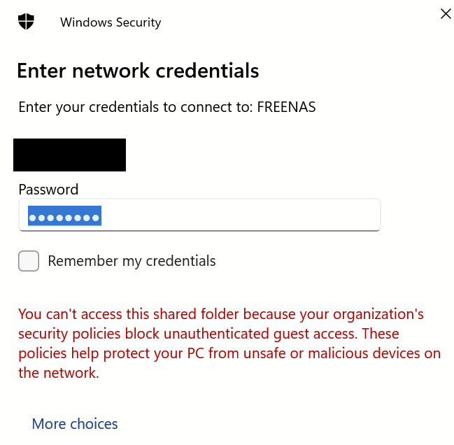

I am seeing the same problem from Linux, Windows and MacOS so it definitely seems to be TrueNAS side. I’ve tried checking SMB configurations, rebooting, and also with both the IP and hostname on all machines. No difference.

Windows:
