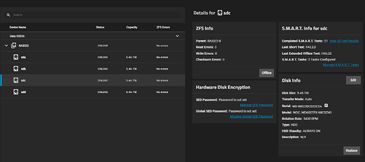

I just realized I have image posting permissions on this forum now
This is the vdev normally

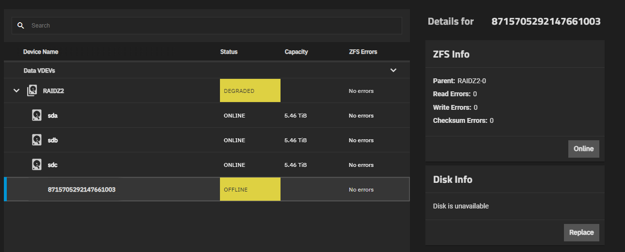

This is when I removed sdd

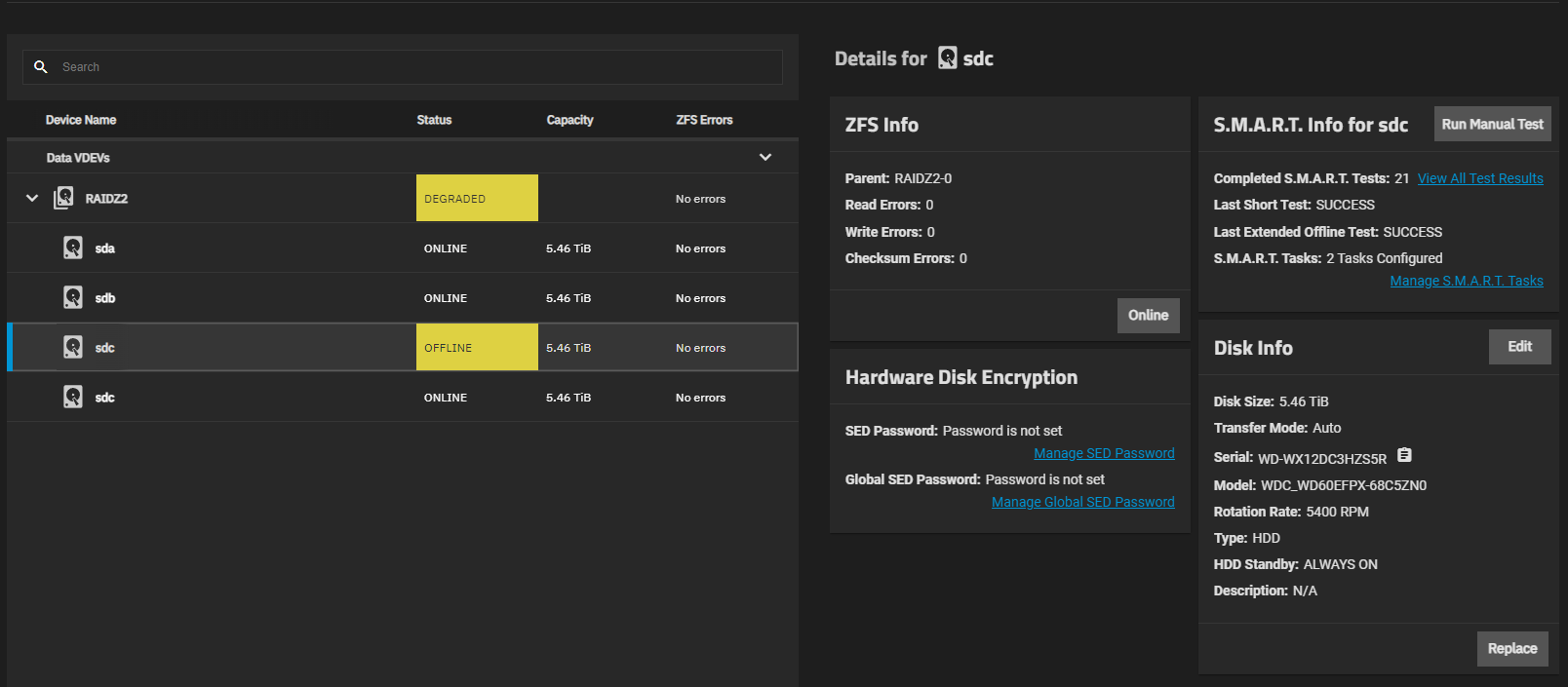

and this is when I removed sdc
notice all the odd things going on in the UI.
I’m not putting the new disk in again until I resolve this, so imagine the new disk taking the sdc name instead of recognizing that old sdc became UNAVAIL and that there’s a new disk. I click on sdc, it shows another disk’s serial number. I open the Replace menu and there isn’t any disk I can choose. I try online-ing it and it immediately faults.
Actually, I’m not even sure if the new disk took sdc or some other name, as I don’t remember which serial number appeared
