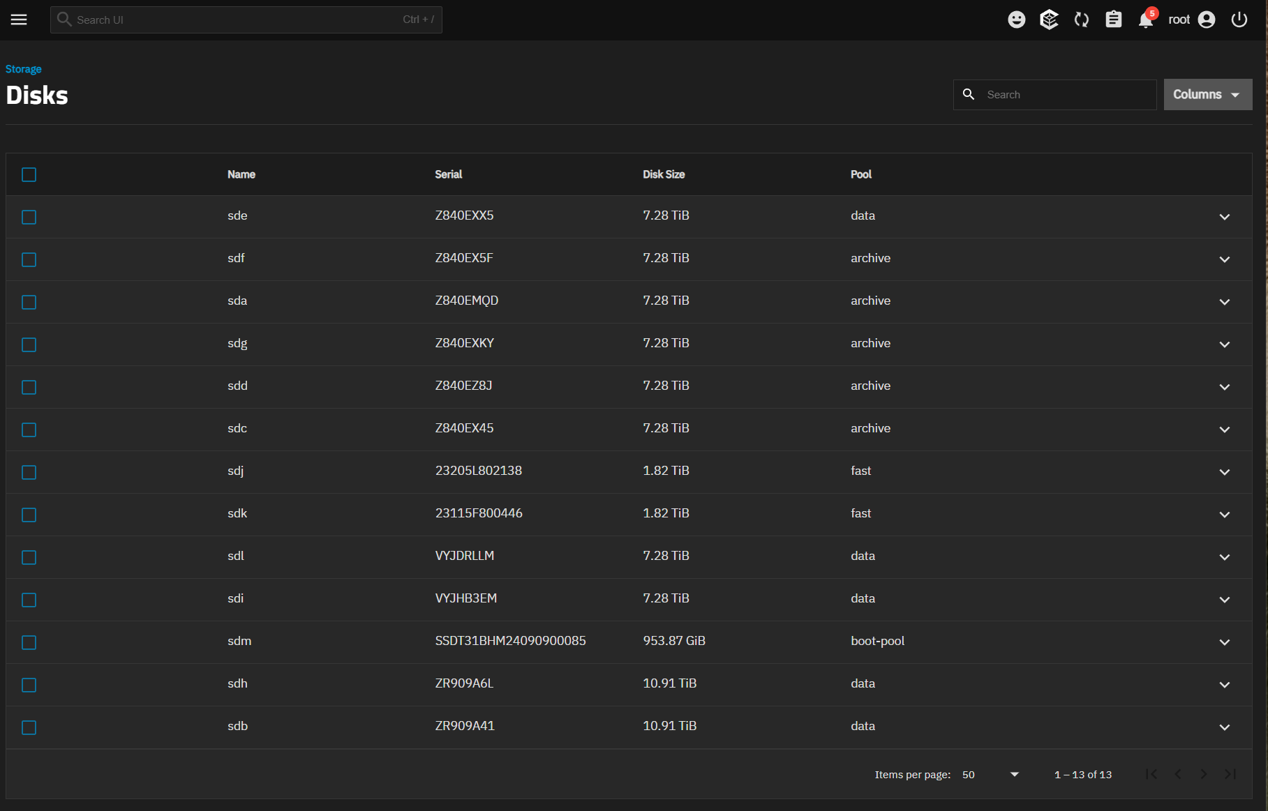

However now I notice that TrueNAS thinks one drive from my “Archive” pool is in my “Data” pool. The common thing I notice here is TrueNAS scale seems to address my drives as sda through sdm instead of a GUID like TrueNAS core did.
Originally I had 4x WD Red Plus/Pro 8TB drives in a RAIDZ1 as “Data” pool, and 6x Seagate Archive 8TB drives (I know SMR Bad, but I got them before the issues were widely know and never had to resilver) in a RAIDZ2 as “Archive” pool.
I also have two WD Red 2TB SATA SSDs (one M.2 SATA and one 2.5" SATA) as a MIRROR as “Fast” pool which I use for Apps, VMs, and System DataSet.
The “Boot-Pool” is a SK Hynix SSD connected via USB. It is not a normal flash drive.
HBA is a genuine LSA 9207-8i and since I have more than 8 disks, some are on the Intel Xeon D 1541’s SATA controller which is in AHCI mode.
I’ve had two failures of the WD Red 8TB drives in the “Data” pool and I’ve replaced one successfully with a Seagate IronWolf 12TB drive (ZR909A6L), and now this issue has occurred after the second failure with another Seagate IronWolf 12TB drive (R909A41).
The drives with serial Z840E are the 6x Seagate Archive drives and they should be members “Archive” pool. However now Z840EXX5 is saying it is in the “Data” pool which is not correct.
The “Data” pool currently comprises of the 2x WD Red Pro/Plus 8TB drives with serials beginning with VYJ, and the 2x IronWolf 12TB drives with serials starting with ZR909A.
For some reason TrueNAS UIthinks there are now 5 drives in “Data” and 5 drives in “Archive”. However ZFS CLI knows the true correct state by the looks

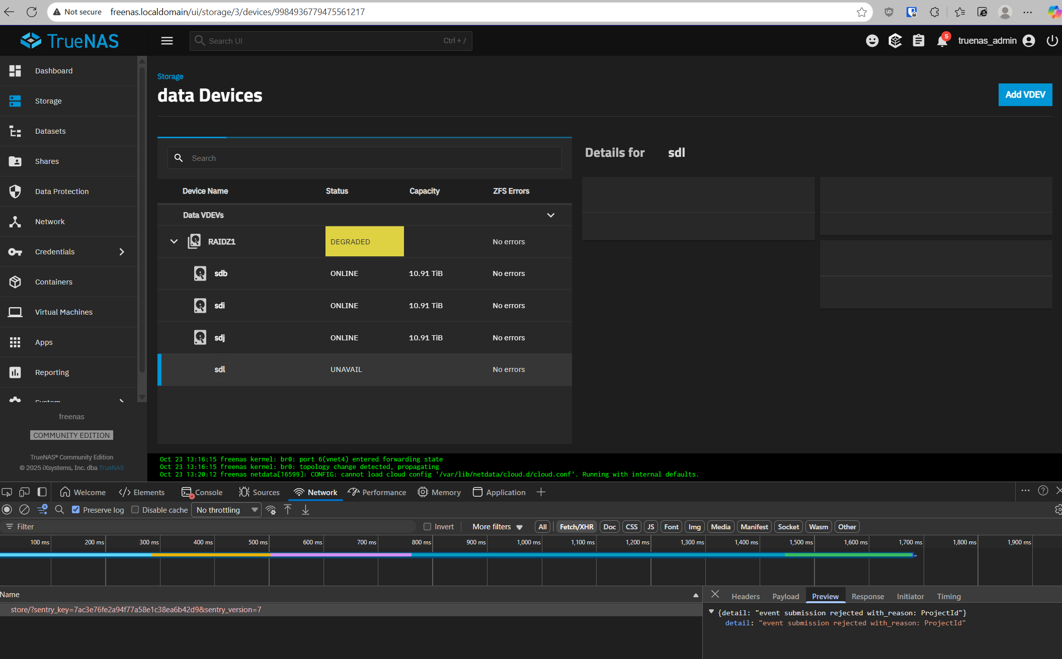

However I attempted to repeat that process with the final 8TB WD drive, and I get this
The whole Web UI goes unresponsive because of this error shown in the browser debug tools.
TrueNAS Scales seems quite buggy compared to TrueNAS Core when it comes to managing drives.
Is there any way to replace from the command line?

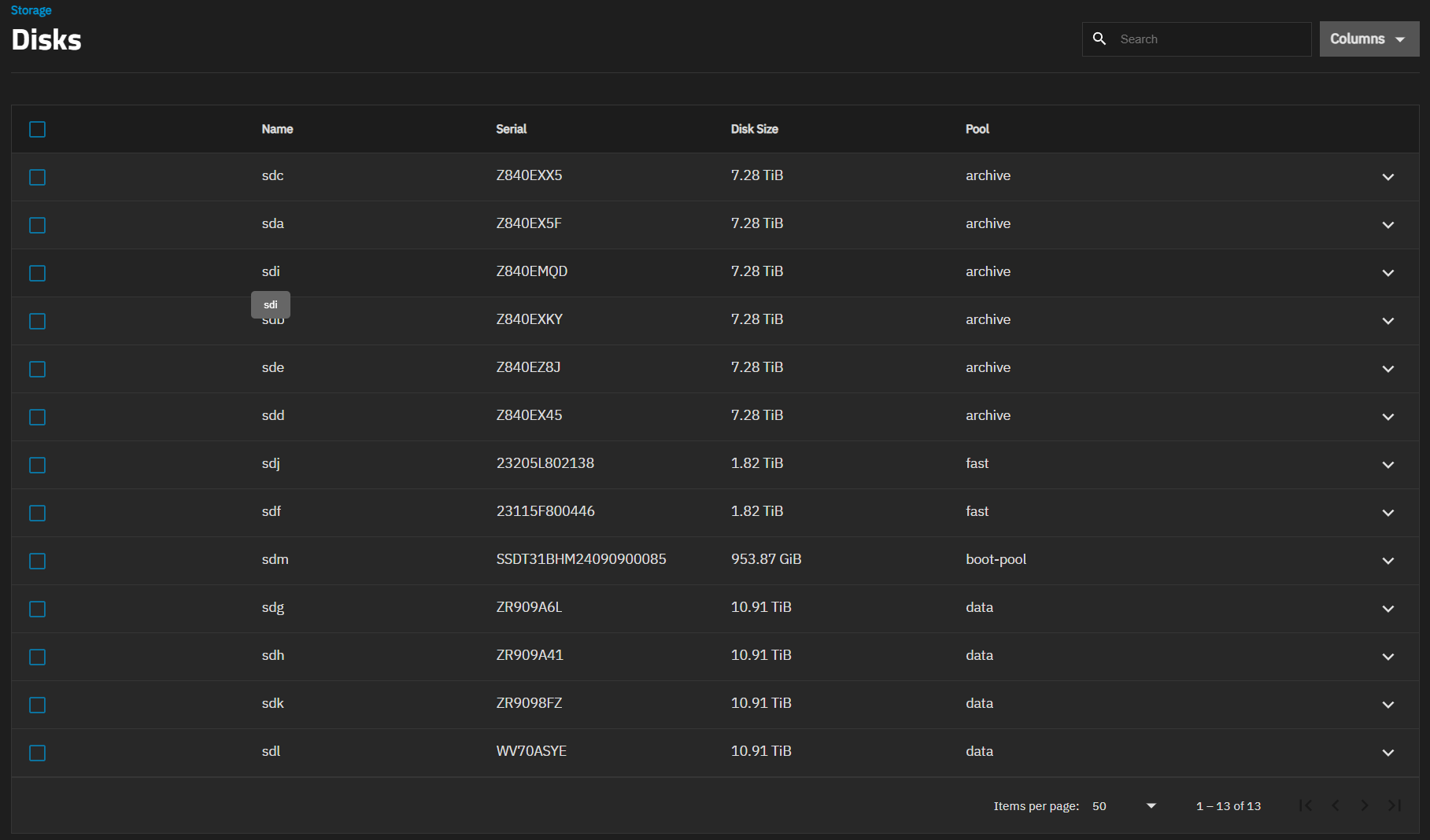

Below is my disk setup now from the UI
and this is what ZFS status is showing

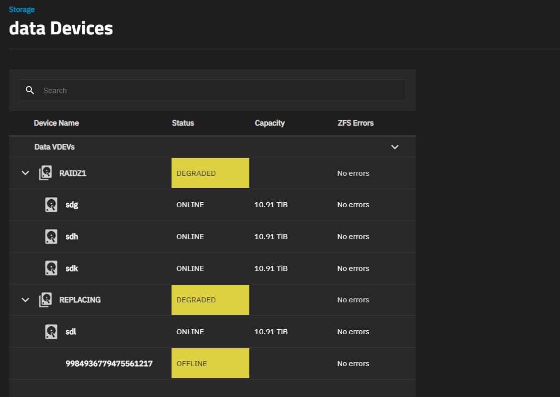

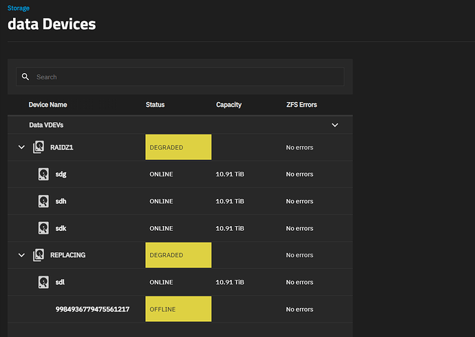

So I put the 8TB WD drive back in and the pool changed from DEGRADED to ONLINE, but as expected ZFS reported corrected errors as data would have changed.
I then offlined the drive again, shutdown, put the new drive in this time without booting up once with no drive in the slot, and this time I was able to see the replace button and click on it, and it all seems to be working.

              sdl2                                  OFFLINE      0     0     0
              d99c57c6-7637-46c8-a958-db69f0217e60  ONLINE       0     0     0  (resilvering)
            f3634186-4f97-46af-8a40-9903c847684b    ONLINE       0     0     0
            da00085c-ee41-424a-bdb2-b79a533f0d3e    ONLINE       0     0     0
            4f4475e1-fad8-4ea1-98d3-8066d650694c    ONLINE       0     0     0
errors: No known data errors
root@freenas[~]#

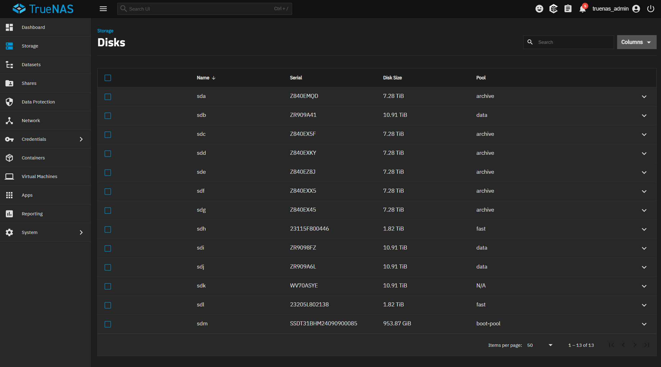

Interestingly as I have replaced drives in my “Data” pool, the drive identifiers have changed from sd*# back to a guid like my system had when it was TrueNAS Core 13 based.
Why did TrueNAS Scale switch to the sd*# naming convention for disks in the pool in the first place?
I remember it was a pain to identify which guid matched which drive, but last time I replaced drives under TrueNAS Core, I just found a command to figure out which drive serial number matched to which guid that ZFS reported the error on (offlined the drive if I could), then pulled that drive using the serial number sticker on the drive (Thank you Seagate for putting serial number stickers where I can see the serial number without pulling the drive).
One thing I noticed is while zfs commands use the guid now, the TrueNAS UI still uses the sd*# identifier
The drive resilvered fine and after a reboot both the Storage → Disks and Storage → data Devices pages showed the correct info.
