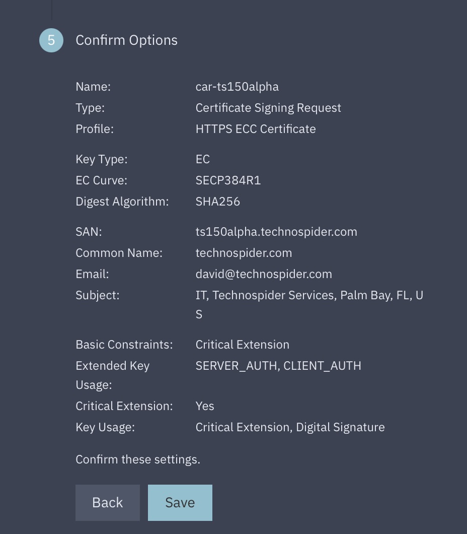

I just set up my 3rd TN server. I’ve had no issues using the built in tools on the other 2 in order to set up and use LE SSL certs. On this 3rd server when I click save on the CSR I get a box that pops up for about 1/10th second, then goes away. All my settings look correct. What log would I check to try and track down the issue?

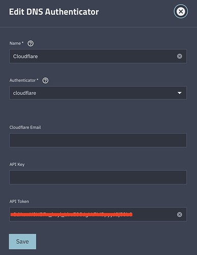

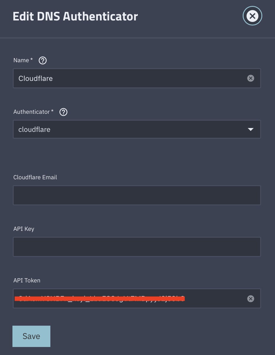

I created a new API token on Cloudflare with zone read and dns edit properties:
Then I made a new csr with standard options set:

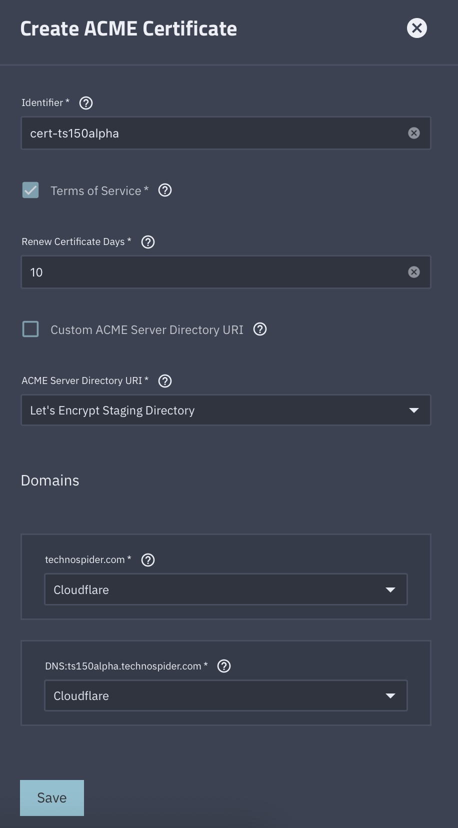

Then I tried to get a cert:
I tried with production a few times, then switched to staging as I didn’t want to blow out my requests depending one what’s going on.

You should never paint over your secrets like that. Chars can be guessed by their visible parts and width. I suggest you revoke this token.

I hadn’t use the built-in truenas mechanism for cert issuing (because it doesn’t have my dns provider). However, the staging directory on this screen
seems kinda strange. Or did you choose it on purpose for preventing limit exhaustion?

Didn’t pay enough attention – my bad.
