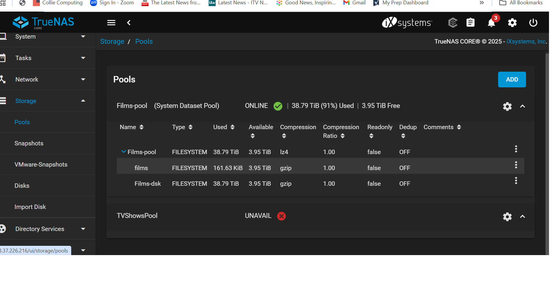

I’ve replaced my da2 disk twice, it’s failed each time. I now suspect the cable, I’ve bought a new one, but is there anything I can look at to point me to the cable and help me differenciate between cable and disk. I hope it’s not the onboard controller. as I have no slots spare to plug in a new on, so it would be a new server, which I can’t afford.
It failed in the middle of a pool scrub, will that create any additional problems?
Thank you for you help

  • Pool TVShowsPool state is UNAVAIL: One or more devices are faulted in response
    to IO failures.
    The following devices are not healthy:
  • Disk TOSHIBA HDWG21E 2490A06NFP7G is REMOVED
  • The TVShows pool is offline.

I’m concerned that it was in the middle of scrubbing the pool when it died.
This is the pool’s status;
When it was powered off I opened up the server and reconnected ada2’s data connector, maybe that’s why the disk isthere now, even it it’s not in the pool
I know it’s a stripe0, and the data has potentially gone, but I have a good backup.

Once I get the cable, later today, is there a way of adding the removed disk back into the pool to bring the pool online? Or is the pool effectivly dead and I’ll delete it, recreate it and start again?
Thanks
It is all gone. A stripe with a single failed drive is a complete failure of the entire pool. You need to treat a Stripe as if it were a single drive, any part of that drive fails and the entire thing fails.
You are better off creating a RAIDZ1 or bette a RAIDZ2, but that depends on how important the data is to you.
You might be lucky and it may jump back into life but like @joeschmuck said you have to assume it’s lost as by design losing a drive in a stripe loses the pool.

The reason I had a stripe 0 was I didn’t have a spare port to plug in the extra drive. However thanks to Alister I have another look at the mother board and discovered a spare ODD sata port, after checking online Dell SATA ODD ports are no different to the other mini sas sata ports, so that gave me the extra port for the drive to give me raidz1, which I implemented,
I swapped the drives around, and the physical disk that was in ADA2 failed on a pool scrub again, although was perfectly ok before a throught check during the scrub. As I have Raidz1 all the data’s safe and I don’t have to wait 5 days for it to be restored.
GREAT news it’s the disk, not the controller, I’d swapped the cable. Weird in that fact it was in the same place as a previous one, but coincidental. It’s in warraty and waiting for UPS to pick it up.
