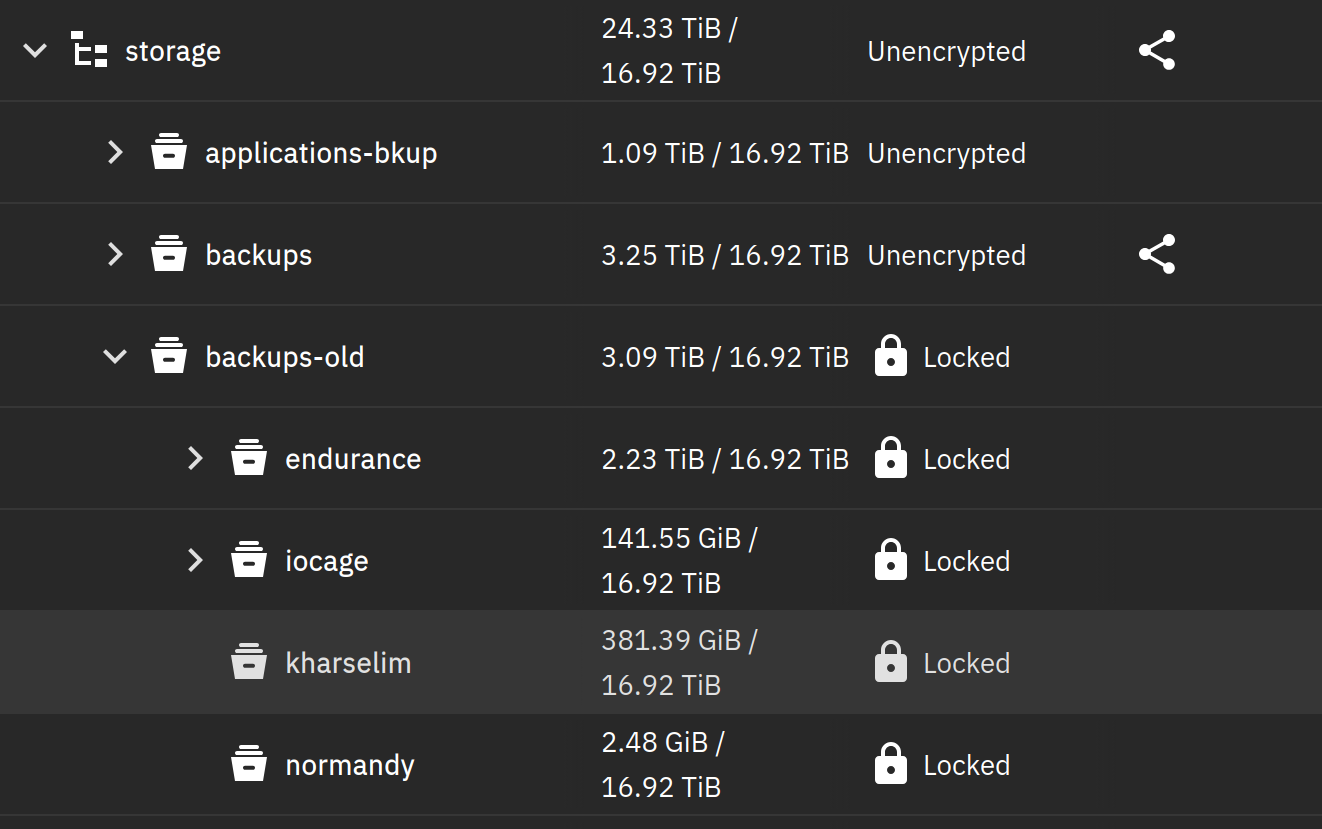

Datasets no longer decrypted on boot - any way to recover?
For the first time in over a year I needed to access some very old system backups, and found that the dataset was locked.
This kind of thing has happened before on Scale, and normally in this situation I export the parent dataset’s key and use it to unlock the children ones… Except here the locked dataset is the top level encrypted one.
Is there a way to access the datasets keys, or prompt TrueNAS to un-forget them?

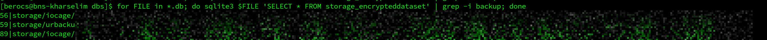

Checking the running system’s database, 128 datasets and keys are listed. None of them match the backups-old or child datasets.
I did rename backups-old from the original name ‘backups’. Possibly that is where things went awry?
I have configuration backups for about two years of upgrades. Most of them should have the “export secret” option selected.
I used your query in a for loop to go through each .db file and grep out ‘backups’ and the child dataset ‘raid’. Neither turned up.
I think so. There is some code in the middleware which deletes “wrong” keys every 24 hours (source). Rename isn’t supported by TrueNAS, so the key was still stored as being for the storage/backup dataset. That’s probably why the key got deleted.
So you would likely need a backup before the rename. But it looks like you already checked all the backups. Unfortunately, I don’t see another option to recover those keys.
