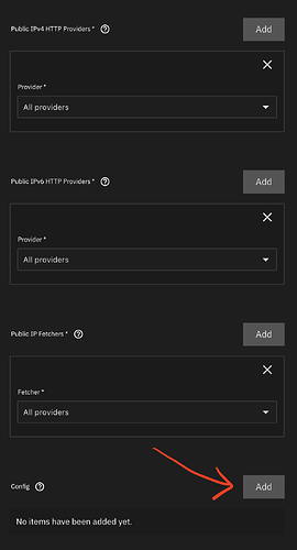

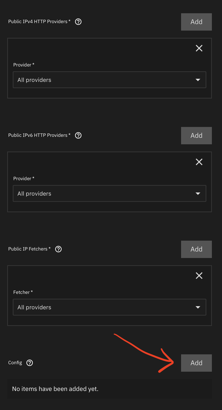

Scroll down and use the dropdown menu under “Config” section. Leave everything above as “All providers”
What Emo said. The documentation clearly needs an update.
Thank you! Leaving breadcrumbs for those that follow because after much searching this chain finally pointed out what is needed to set up DDNS-Updater in TrueNAS 25.04 Fangtooth. DDNS-Updater is at TrueNas App v2.9.0 project v1.2.13 but the documentation is still out of date so it was not clear that you have to use the add config menu, then when you select your provider it will generate the relevant fields.
