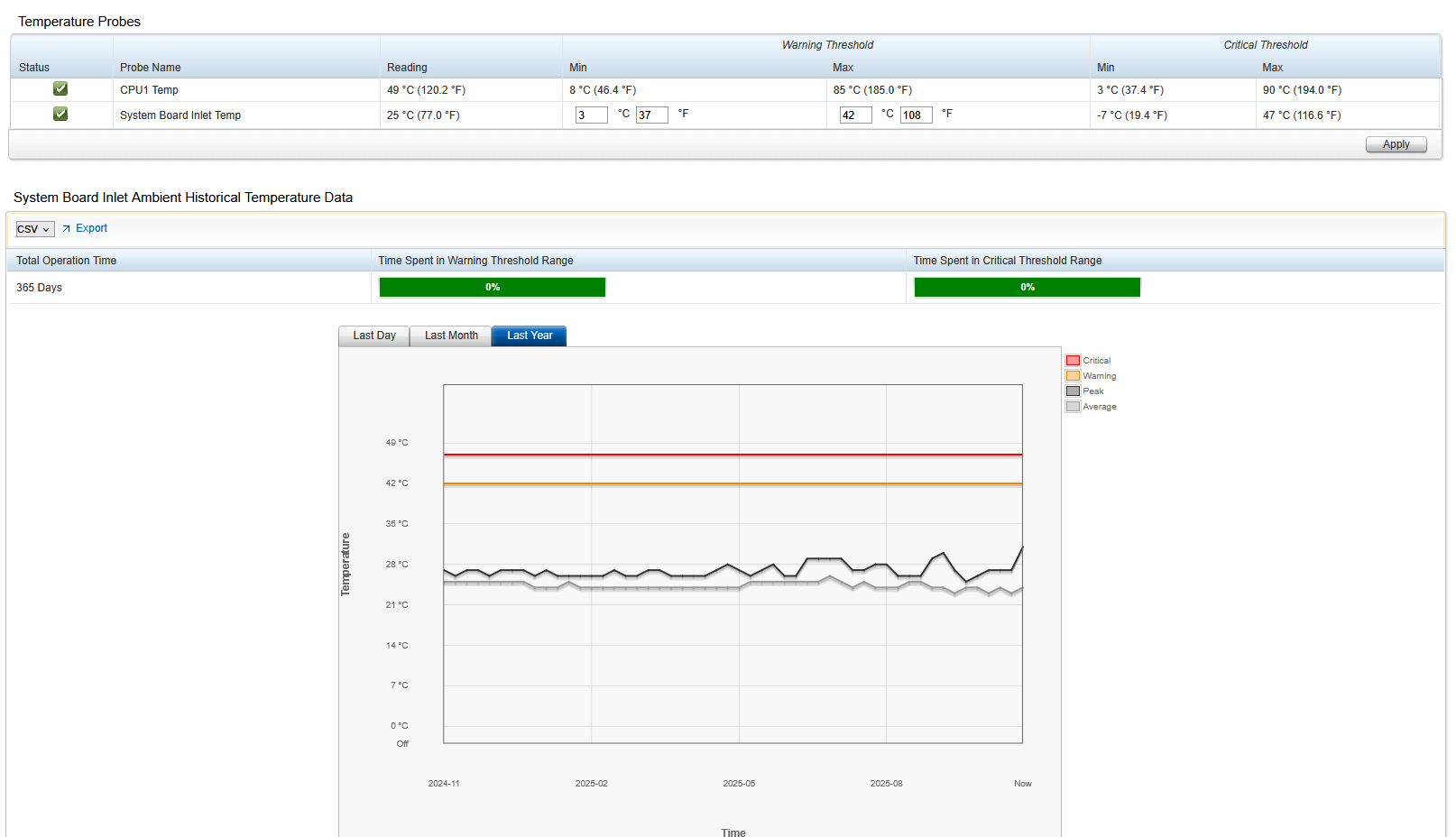

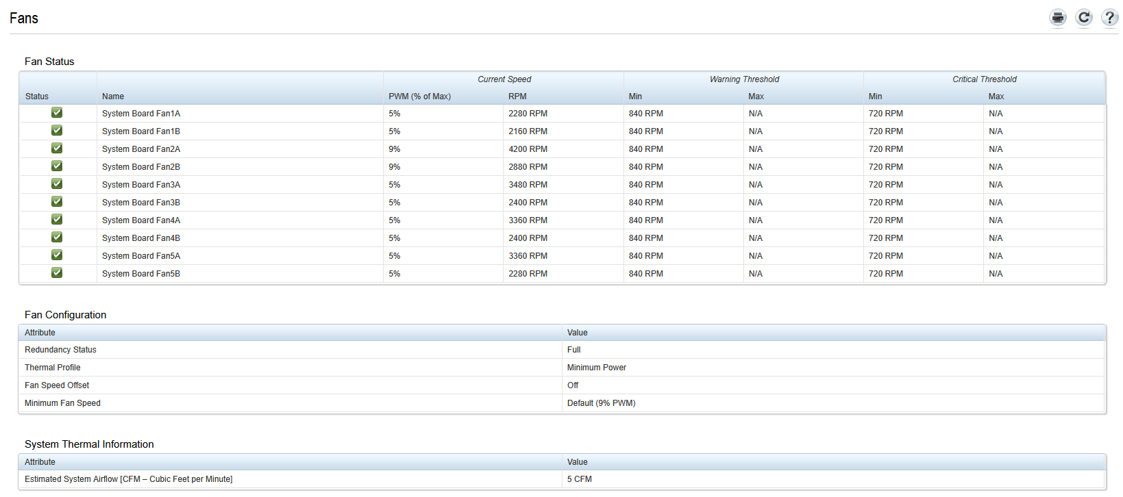

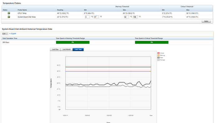

7) iDRAC thermal/fan settings
Open the iDRAC web UI:
  1. Service Module → Setup: Confirm Installed Version on Host OS shows 5.3.0.0 and Status = Running`.
  2. Service Module → Monitoring:
    • Third Party PCI Fan Response = Disabled
    • Leave Fan Speed Offset = Off (unless you need a fixed uplift)
  3. Fans → Setup:
    • Thermal Profile = Minimum Power (Performance per Watt Optimized)
Verify from the host:
sudo ipmitool sdr type temperature
sudo ipmitool sdr type fan
Healthy idle targets (room ambient ~22‑25 °C):
  • Inlet ~23–25 °C
  • CPU ~37–41 °C
  • Fans mostly 2,000–3,000 RPM, with one or two zones higher depending on chassis/drives
  • Fan Redundancy = Fully Redundant

I am also running Truenas Scale on a Dell r430, and I installed two NVME cards in the high rise PCIe slots which made the fans go full blast.
Truenas already has the “ipmitool” installed by default, and I now have a cron script running to monitor and control the fan speeds as the temperature changes.
So if you are only interested in monitoring the fans and CPU, then you really don’t need developer mode.
Below is the log output of the cron script that runs every 5 minutes.
I have two CPUs so it takes the highest temperature.
Running script via cron on Sat Oct 25 13:05:02 BST 2025
Temperature Data Collected: INLET_TEMP=26, CPU_TEMP=64
Power Data Collected: INSTANT_POWER=111
Managing fan speed for temperature: 64
Setting fan control mode to Manual and speed to 8% PWM
Cron job completed at Sat Oct 25 13:05:03 BST 2025
Cheers
