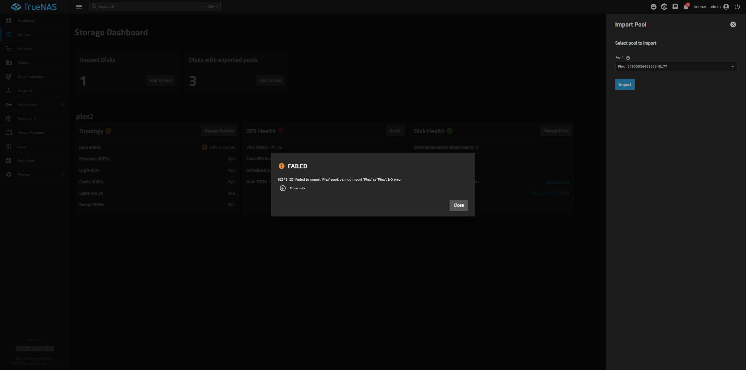

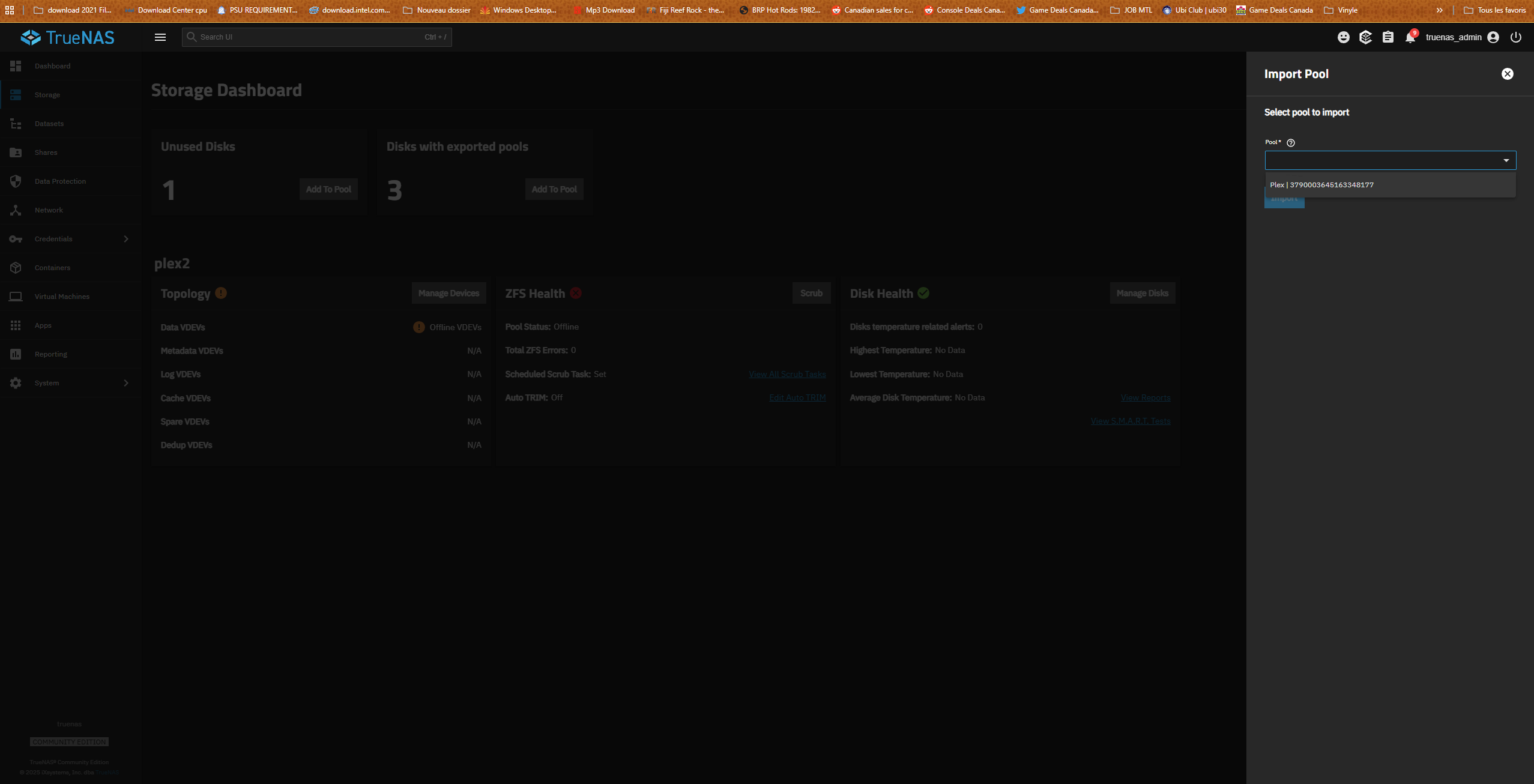

if i go on storage import pool i see plex but i receive error.
( concurrent.futures.process.RemoteTraceback:
File "/usr/lib/python3/dist-packages/middlewared/plugins/zfs
/pool_actions.py", line 233, in import_pool
zfs.import_pool(found, pool_name, properties, missing_log=missing_log, any_host=any_host)
File “libzfs.pyx”, line 1374, in libzfs.ZFS.import_pool
File “libzfs.pyx”, line 1402, in libzfs.ZFS.__import_pool
libzfs.ZFSException: cannot import ‘Plex’ as ‘Plex’: I/O error

middlewared.service_exception.CallError: [EZFS_IO] Failed to import ‘Plex’ pool: cannot import ‘Plex’ as ‘Plex’: I/O error

middlewared.service_exception.CallError: [EZFS_IO] Failed to import ‘Plex’ pool: cannot import ‘Plex’ as ‘Plex’: I/O error )
