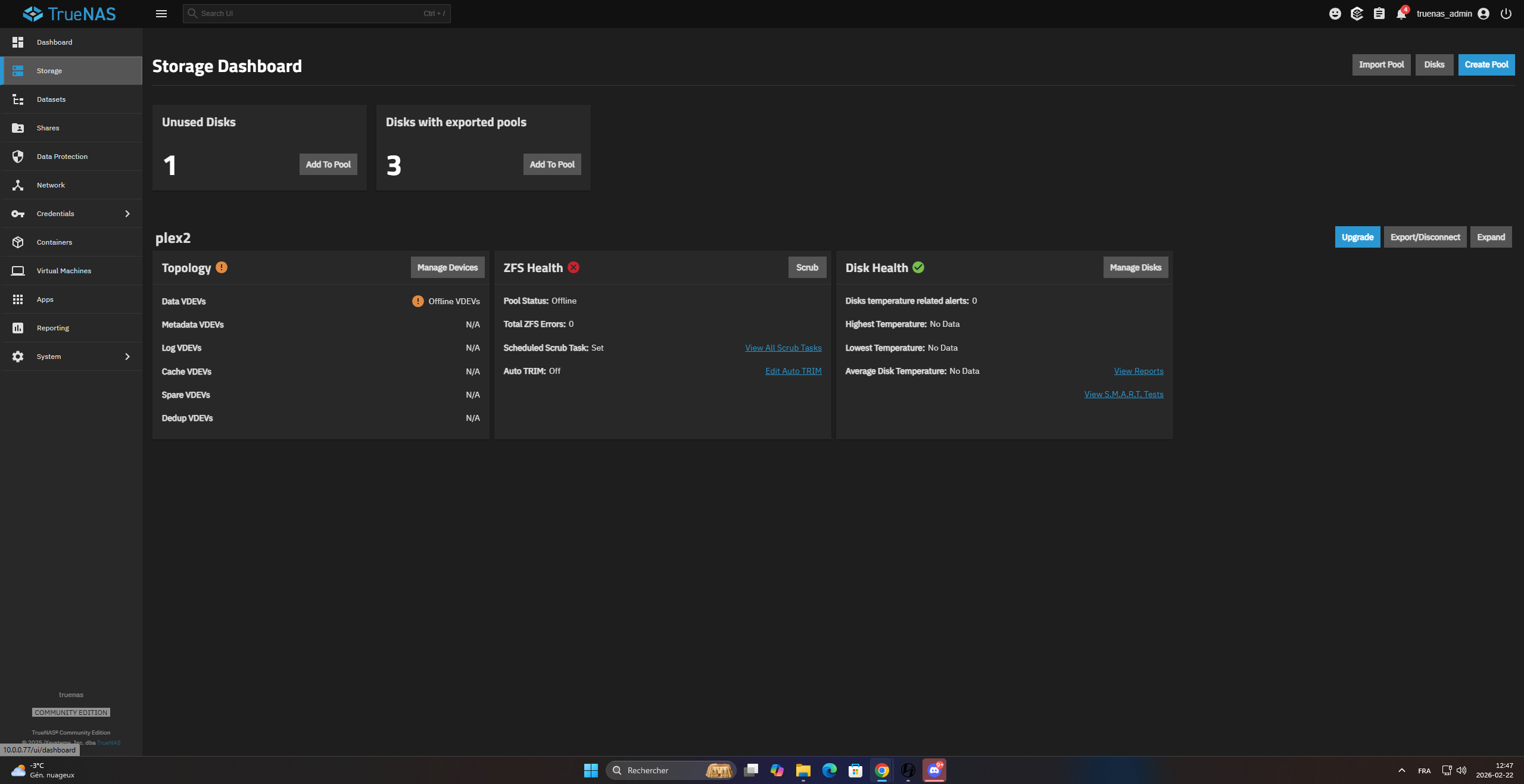

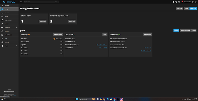

Disks with exported pools after 1 die. cant import offline Vdev
how i can do that ? i can write spec of the pc
yes hba card LSI 9211-8i Mode IT
pool Plex + plex2 RaidZ1
truenas Version: 25.04.2.6
Cpu- i9 9900k
MB: Asus PRIME H370M-PLUS
Ram : kingston Ram 64gb i dont remember the speed ( i know is No-ECC ram , maybe upgrade later for new mainboard can take Ecc ram )

the unavail is the old disk die. the new disk i do badblock and smart test and all is ok.
i post answer to your question. now im ready do listen .

hello, I don’t know if anyone has a few minutes to try to solve my problem. I know that no one is obligated but it would be greatly appreciated and I know that all people have a family and other things more important and that life does not just revolve around a stranger in difficulty.
thank you very much
@HoneyBadger could you look at Disks with exported pools after 1 die. cant import offline Vdev - #48 by vooxelite
no answer. what i can do now ?
I haven’t heard anything either. You could try waiting a few more days for a reply or I would just consider the pool lost at this point.
