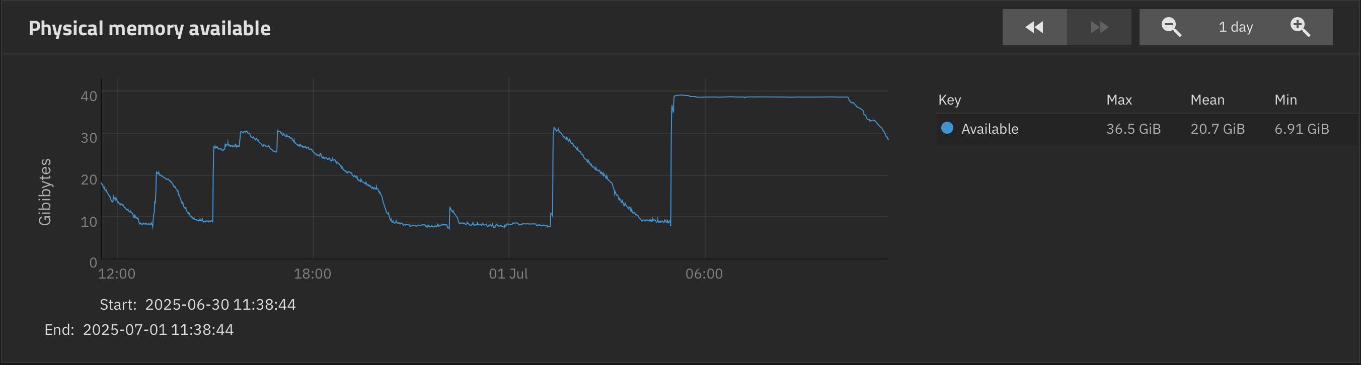

Memory usage is pretty low atm - Home Assistant is the highest at 825MB

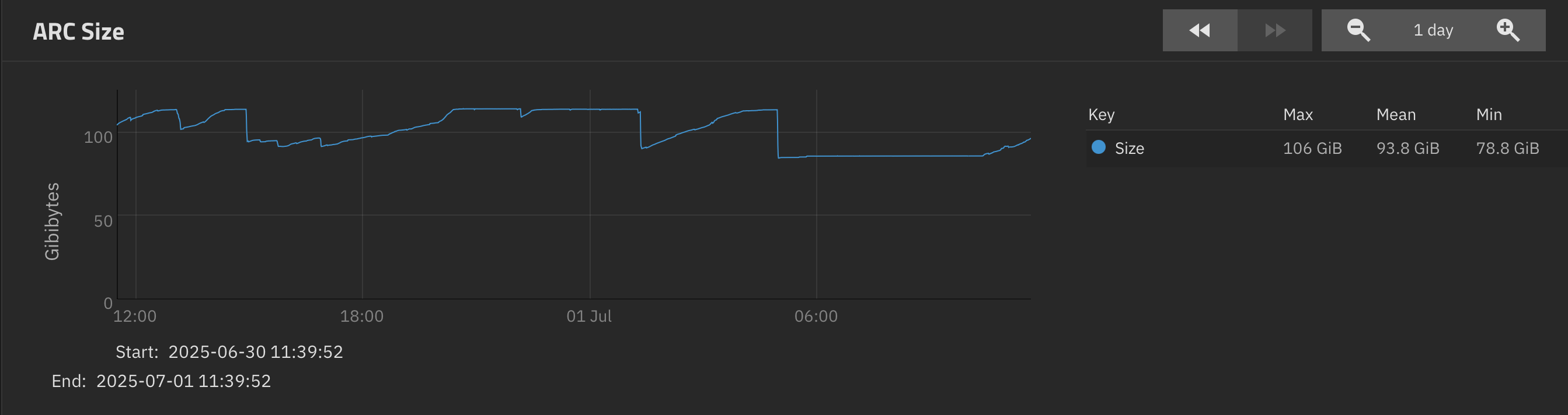

Low free space may cause memory starvation issues if there are lots of write operations or a few large write operations ongoing. The I/O slows down due to the lack of free space and the write buffers in the ARC fill up, then the application generating the I/O has to slow it’s writes potentially leading to more memory consumption.
I suspect the mbuffer processes are related to the replication via an ISP connection, but those alone should not drive the system out of memory. It may be a combination of the replication and something else that runs that is memory hungry.
I would watch the memory usage and kick off a replication and see how much memory is used.

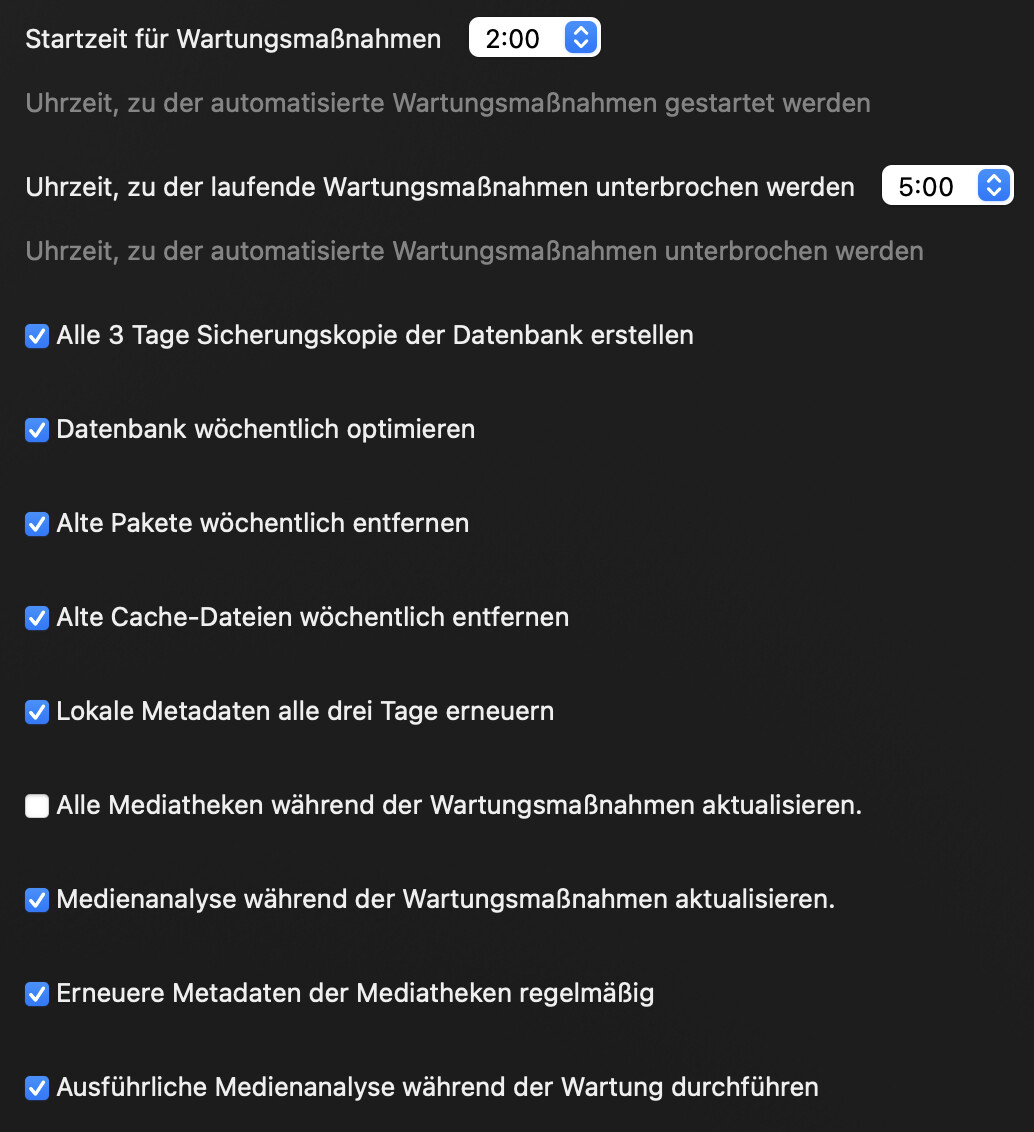

This night, only stash app crashed - I started a “generate metadata” task a few days ago - this needs some time because the library is big.

The memory was low but not zero
The replication tasks are still disabled.
I started to clean pool1 and free space is now 3 TB. Even though it is just around 90% it am not sure it this is the problem with this crash today?

Warning - following is a workaround & not a fix:
echo  #SIZEINBYTESHERE# >> /sys/module/zfs/parameters/zfs_arc_max
ARC should dynamically reduce in size to ensure everything else in system has enough memory. This would manually set the limit (try out 50-75% limit).
This is not a fix, you’d still need to find the leak (might not necessarily be a memory leak). This would just give a bit more free space as ARC needs a few units of time to reduce itself & that might be the difference between whatever you’re doing finishing successfully so you can figure this out without crashing… or not.
Edit:
I’d start keeping top -o %MEM open to try and catch anything unusual…
2nd Edit:
This command won’t survive any reboots… I’ve also personally noticed that it also doesn’t survive starting/stopped any VMs.
