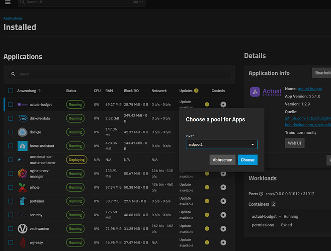

Here the Proof that i have Apps installed and ive choosen ssdpool1
I have a lot more containers but the containers i installed per Portainer arent shown.
