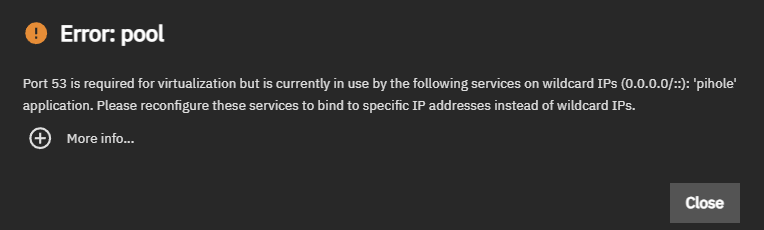

When trying to start an Instance it complains that my pihole app is bound to port 53, which Instances needs evidently:
Can I simply go into the pihole app and change its DNS port without any issues? Or do I need to do something else?

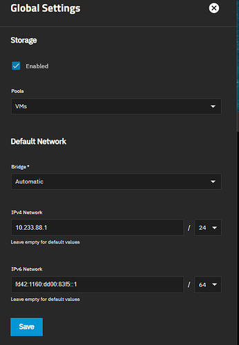

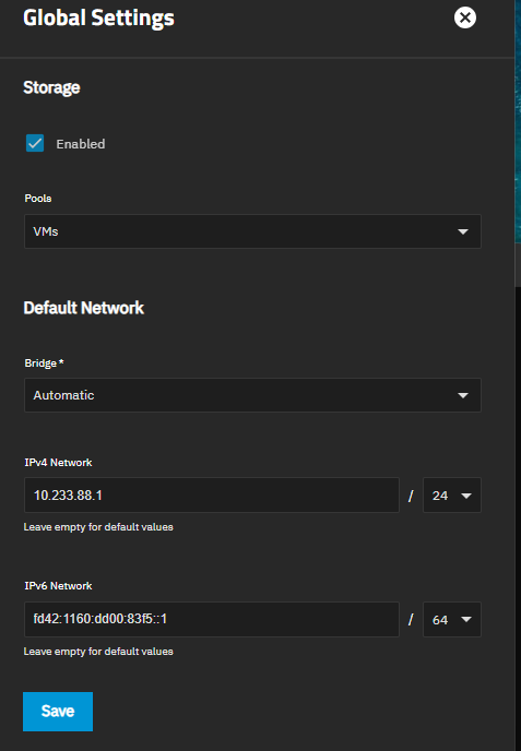

  1. Ensure that Instances (Incus) is not using the same IP address that you want to use for Pi-Hole. Instances -> Configuration -> Global Settings, Incus will run a DNS server on port 53 on the configured default global networks.

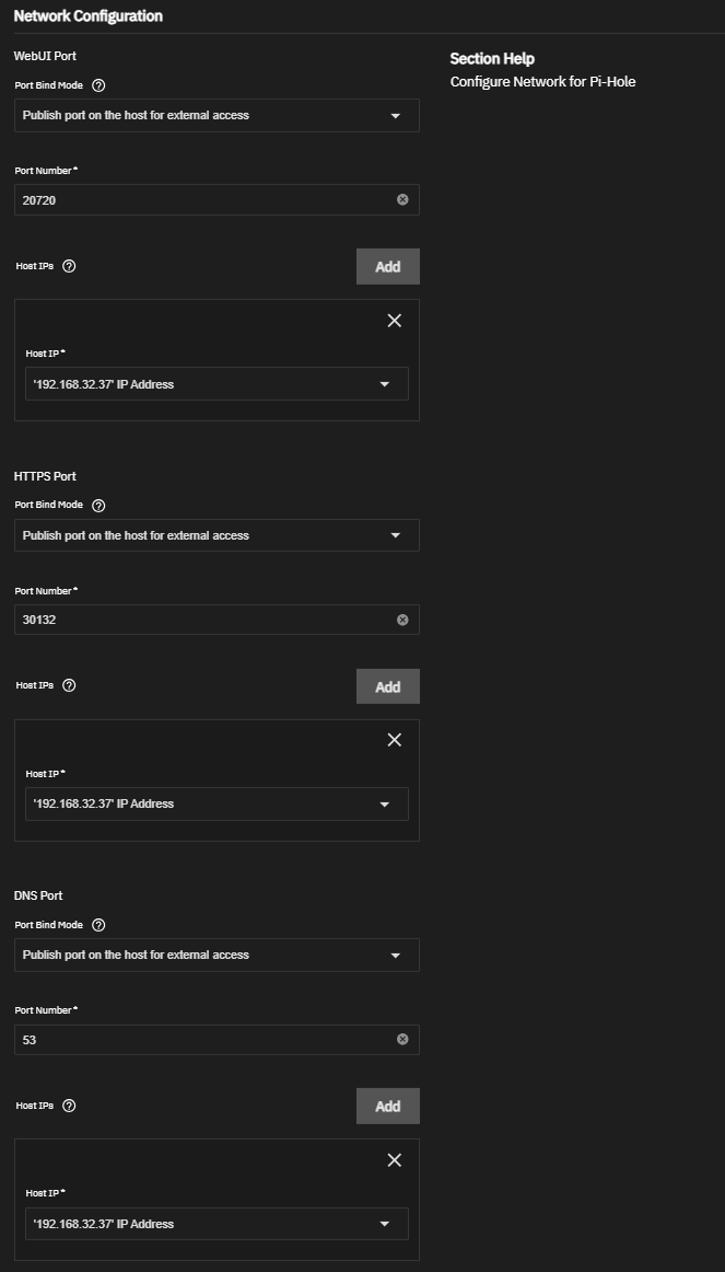

  1. When you deploy the Pi-Hole App you need to specify three separate networks (address and port) for HTTP user interface, HTTPS user interface, and DNS service. Use a different IP address for Pi-Hole than you used for Instances.
After doing the above, Pi-Hole started just fine and bound only to my LAN on port 53. Technically, it was a Docker proxy that bound to the ports for HTTP/HTTPS/DNS and proxies the traffic to Pi-Hole.
xxx% sudo netstat -apn | grep LISTEN | grep docker-pr
tcp        0      0 192.168.32.37:53        0.0.0.0:*               LISTEN      2131748/docker-prox
tcp        0      0 192.168.32.37:30020     0.0.0.0:*               LISTEN      517825/docker-proxy
tcp        0      0 192.168.32.37:20720     0.0.0.0:*               LISTEN      2131778/docker-prox
xxx%
