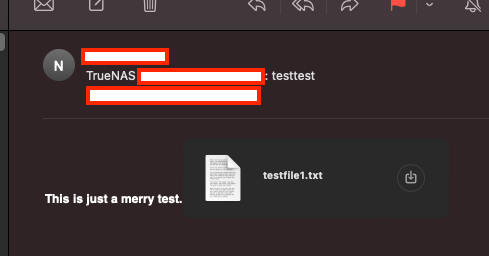

Hereās a command that works for me:
curl -v -u santa:hohoho -F 'data={"method": "mail.send", "params": [{"subject": "testtest", "to": ["santa@icepole.net"], "html": "<b>This is just a merry test.</b>", "attachments": true}]}' -F "file=@/mnt/icepool/home/santa/attachment1.json" http://127.0.0.1/_upload/
The contents of the attachment1.json-file is:
"headers": [
"name": "Content-Transfer-Encoding",
"value": "base64"
"name": "Content-Type",
"value": "application/octet-stream",
"params": {
"name": "testfile1.txt"
"content": "IyB+Ly5wcm9maWxlOiBleGVjdXRlZCBieSB0aGUgY29tbWFuZCBpbnRlcnByZXRlciBmb3IgbG9naW4gc2hlbGxzLgojIFRoaXMgZmlsZSBpcyBub3QgcmVhZCBieSBiYXNoKDEpLCBpZiB+Ly5iYXNoX3Byb2ZpbGUgb3Igfi8uYmFzaF9sb2dpbgojIGV4aXN0cy4KIyBzZWUgL3Vzci9zaGFyZS9kb2MvYmFzaC9leGFtcGxlcy9zdGFydHVwLWZpbGVzIGZvciBleGFtcGxlcy4KIyB0aGUgZmlsZXMgYXJlIGxvY2F0ZWQgaW4gdGhlIGJhc2gtZG9jIHBhY2thZ2UuCgojIHRoZSBkZWZhdWx0IHVtYXNrIGlzIHNldCBpbiAvZXRjL3Byb2ZpbGU7IGZvciBzZXR0aW5nIHRoZSB1bWFzawojIGZvciBzc2ggbG9naW5zLCBpbnN0YWxsIGFuZCBjb25maWd1cmUgdGhlIGxpYnBhbS11bWFzayBwYWNrYWdlLgojdW1hc2sgMDIyCgojIGlmIHJ1bm5pbmcgYmFzaAppZiBbIC1uICIkQkFTSF9WRVJTSU9OIiBdOyB0aGVuCiAgICAjIGluY2x1ZGUgLmJhc2hyYyBpZiBpdCBleGlzdHMKICAgIGlmIFsgLWYgIiRIT01FLy5iYXNocmMiIF07IHRoZW4KCS4gIiRIT01FLy5iYXNocmMiCiAgICBmaQpmaQoKIyBzZXQgUEFUSCBzbyBpdCBpbmNsdWRlcyB1c2VyJ3MgcHJpdmF0ZSBiaW4gaWYgaXQgZXhpc3RzCmlmIFsgLWQgIiRIT01FL2JpbiIgXSA7IHRoZW4KICAgIFBBVEg9IiRIT01FL2JpbjokUEFUSCIKZmkKCiMgc2V0IFBBVEggc28gaXQgaW5jbHVkZXMgdXNlcidzIHByaXZhdGUgYmluIGlmIGl0IGV4aXN0cwppZiBbIC1kICIkSE9NRS8ubG9jYWwvYmluIiBdIDsgdGhlbgogICAgUEFUSD0iJEhPTUUvLmxvY2FsL2JpbjokUEFUSCIKZmkKCiMgQ3VzdG9tIGNoYW5nZSBzZXQgUEFUSCBzbyBpdCBpbmNsdWRlcyBzeXN0ZW0gYmlucwpleHBvcnQgUEFUSD0iL3Vzci9sb2NhbC9zYmluOi91c3Ivc2Jpbjovc2JpbjokUEFUSCIK%"
In the above example I base encoded my sacrificial .profile using:
base64 --wrap=0 .profile
And then I copy/pasted that output as a value to the ācontentā-property in the json, as shown above.
The result is a mail like follows:
In theory it should be a simple matter of just adding another pair of -F "file=@/mnt/icepool/home/santa/attachment2.json" or similar, but I havenāt gotten that to work, I still only get a single attachment.
