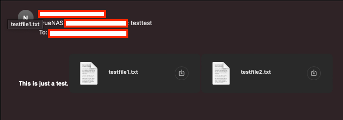

Update, I got it to work:
  "headers": [
    "name": "Content-Transfer-Encoding",
    "value": "base64"
    "name": "Content-Type",
    "value": "application/octet-stream",
    "params": {
     "name": "testfile1.txt"
  "content": "<base64_encoded_string_from_file1>"
  "headers": [
    "value": "base64"
    "params": {
     "name": "testfile2.txt"
  "content": "<base64_encoded_string_from_file2>"
I had the wrong delimitation, the above results in two files. Obviously you replace the <base64>-comments with the actual base64 strings.
Thanks @oxyde for your suggestion!
