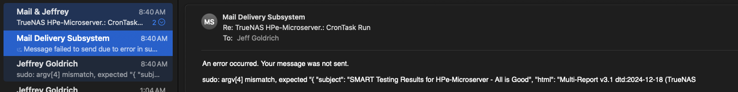

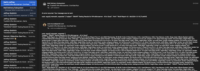

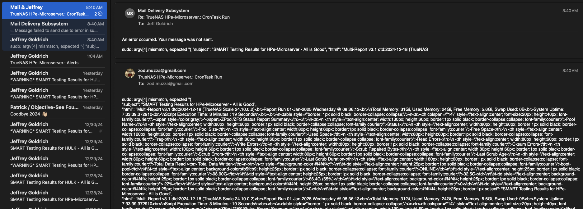

Hmmm … I updated my emailing library script. My script runs from the CLI but will not run from a cron job. Further, the cron job is not giving me any of the standard (or error) output. Swapping back to my old email script and I do get the standard (or error) output emailed to me.
I will compare my two email scripts and see what change is borking the standard (or error) output from a cron job.

Same here for 24.10.1. More security ā€œfeaturesā€ I suspect. I use to use ā€˜root’, but that fails now. This stuff is really killing me. I’m not a real computer IT guy, permissions is something sort of new to me for a home computer. User aname and password, that is all I need. So I have setup a new admin account, it works fine using SSH, but still not in CRON.
