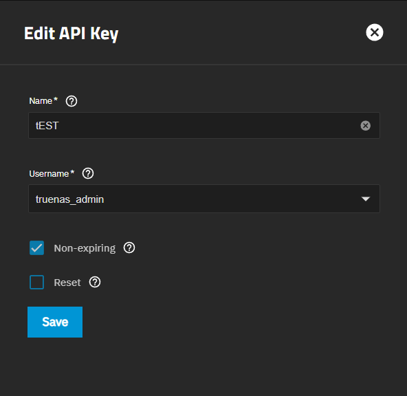

@oxyde Not certain I will have the time to do that tonight, definitely tomorrow. I need to create my API Key.
Question (if you know the answer): How important is keeping the API key secret? Can we give it out and no one could use it anyway because it must match the user account on the local TrueNAS? Just curious. I am always aware of classifications and when I see something that may be impacted, I ask as I want everyone to feel protected.
An API key is essentially root access to your system.
Don’t share it. And it only works on yours.
You should be able to revoke/delete an api key after creating it.
It’s essentially an alternative to the user/password combination.
Exactly as @Stux said.
But IMHO Is better if we use It for mainly a reason: despite atm an api key can just be created i see on documentation that in next version you can also use a context user
Also this will probably mean that this part will be more implemented in future (like adding other usefull features like command or method restriction).
All Is just my personal assumption… But i still think Is a better choice than put user/password on our config file

Starting in 25.04 (next major release) API keys will be per-user-account (inheriting same privileges as the associated user). Otherwise you’re right in saying it’s password-equivalent.
