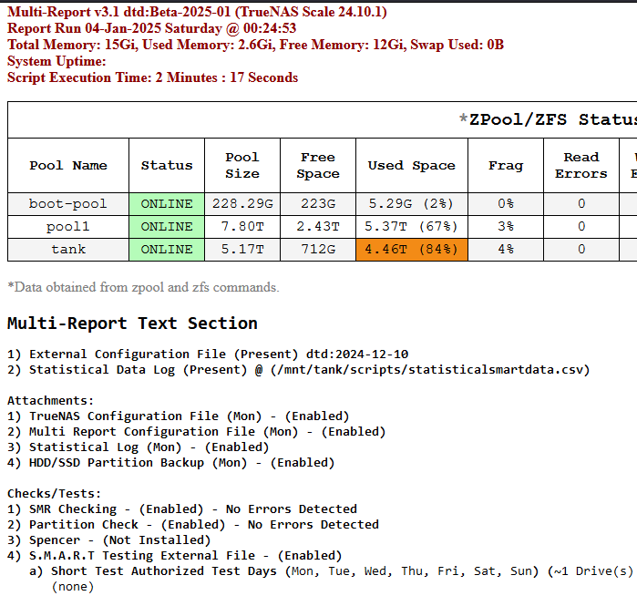

I put a username and password into the top of the script and ran from cron
No useful email here. Script seems to run from cron and I did get an email telling me that the script had run and that it was using curl instead - but no script All is good type email
Running from SSH No email received
Currently running TrueNAS SCALE: ElectricEel-24.10.1
Ran test script from cli as sudo and also via cron. Got the email both times with attached Chart.html.
Noticed that both threw out this:
DANGER Will Robinson, you have 11 drives and 7 authorized days to test.
ROBOT will make adjustments, please wait.... Geez that was fast!
Maybe you need more drives, Waka Waka! ROBOT made a funny.
Recalculation Complete, the new value is 2 drive(s) spread across the 7 authorized days.
    Drive(s) previously scheduled to be tested: sdd, sdc, sde, sda, sdf, nvme1, nvme3, sdb
    Drive(s) scheduled for testing today: nvme2 nvme0
    Drive(s): "nvme0 nvme2" were removed from the Short testing list
    It/They are already scheduled for the Long test, no need to duplicate efforts
So if the first run was supposed to have updated something, it didn’t appear to as the second run reported exactly the same.

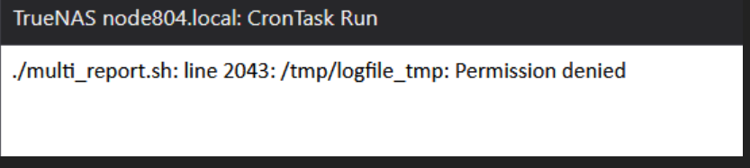

Being logged in the gui via truenas_admin and running it with sudo from shell, it works.
Running as a cronjob as truenas_admin, it sends half a report (Spinning Rust section is missing), and a second email with an error message:
Maybe the cronjob has to run as root or I have to check which rights the truenas_admin has.

As expected it was indeed, running the cronjob as root worked!
Multi Report Cron job working fine indeed as Root. Thanks Joeschmuck and all who helped!
