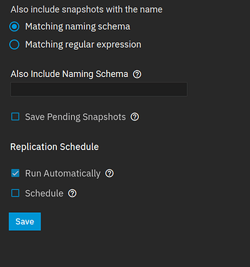

I have tried to recreate the replication task. It seems to be when i put the naming schema in that it starts giving the error
auto-%Y-%m-%d_%H-%M
Even though there is nothing wrong (that i can see) with the “naming schema”

Its easy to reproduce, just fill out any remote replication (i have not tried with local)
before you add anything to the “also include naming schema” box.
and directly after putting a valid schema in the box.

By removing the value in the “Also Include Naming Schema” field, and choosing a valid Periodic Snapshot Task from the field drop down, I was able to make the error go away.
based on info in forum post # 42475/2
