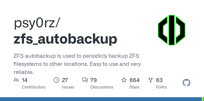

These are my notes on how to install / upgrade ZFS Autobackup:
	https://www.truenas.com/community/threads/howto-using-zfs-autobackup-with-scale.112454/
	https://github.com/psy0rz/zfs_autobackup
	cd /mnt/backup-pool/homedir-ds/home/root/bin
	wget https://github.com/psy0rz/zfs_autobackup/archive/refs/heads/master.zip
	unzip master.zip
	rm master.zip
	mv zfs_autobackup zfs_autobackup.old_$(date +"%Y-%m-%d_%H-%M")
	mv zfs_autobackup-master zfs_autobackup
	cd zfs_autobackup
	python -m venv autobackup-venv --without-pip --system-site-packages
	source autobackup-venv/bin/activate
	curl https://bootstrap.pypa.io/get-pip.py -o get-pip.py
	python get-pip.py
	pip install -r requirements.txt
	deactivate
	VERSION="$(autobackup-venv/bin/python -m zfs_autobackup.ZfsAutobackup --version | awk -F' v' '{print $2}' | awk '{print $1}')"
    echo "Installation of zfs_autobackup ${VERSION} completed successfully"

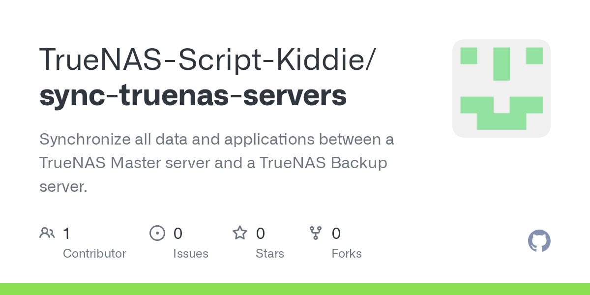

You can find the script that I’m using for my personal / very specific backup-need here:

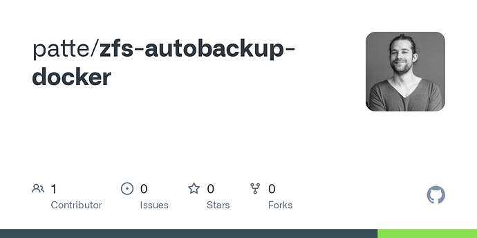

I have no experience with the following, and cannot vouch for it. On the surface it looks clean and usable. It offers a stub script to defer actual operation inside Docker. (Well, it uses Podman. But that’s easily changed.)
Or you could get fancyfancy and try something like this.
touch ./zfs-autobackup
docker run --rm -v ./zfs-autobackup:/zfs-autobackup python:slim bash -c \
    'pip install shiv ; shiv -c zfs-autobackup -o zfs-autobackup zfs-autobackup'

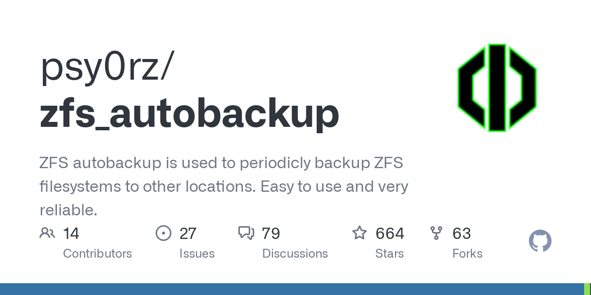

I guess to have found an easier route than pip or Docker:
git clone https://github.com/psy0rz/zfs_autobackup
python3 -m zipapp zfs_autobackup/\
  -o zfs_autobackup.pyz\
  -p "/usr/bin/env python3"\
  -m 'zfs_autobackup.ZfsAutobackup:cli'
This creates a Python self-executable, single file zfs_autobackup.pyz, which can be copied over to TrueNAS machine. (zfs-autobackup does not have required third party runtime dependencies.)
Then on TrueNAS just execute this file:
# ./zfs_autobackup.pyz
This properly invoked above command on my test system and displayed help message. Now I need to figure out, how and what command parameters to use.

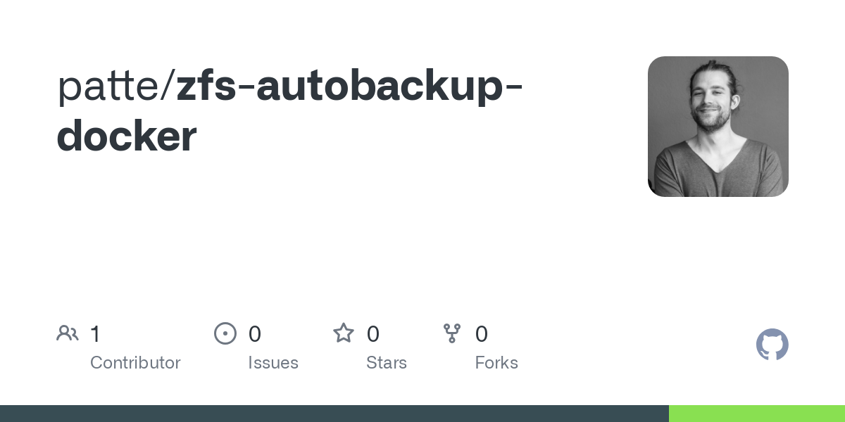

Hello, I’m the author of zfs-autobackup-docker, the container image @jct mentioned earlier. This thread and a poke by psy0rz made me sit down with a TrueNAS instance and figure out a proper way to run zfs-autobackup there, here’s what came out of it.
First I added an opt-in service mode: CRON_SCHEDULE makes the container stay up and run zfs-autobackup on that schedule. This is needed because TrueNAS Apps only know long-running containers.
And there is a ready-made compose file for a TrueNAS Custom App: truenas/docker-compose.yaml. Setup is:
  1. The dataset the backups are received under needs to exist on the ssh target already, zfs-autobackup does not create it: zfs create -p backup/truenas there
  2. Create a config-dataset for the app’s state (ssh key, known_hosts), e.g. tank/apps/zfs-autobackup
  3. Edit the settings block at the top of the docker-compose.yaml: backup name, datasets to back up, ssh target, config-dataset, etc.
  4. Apps → Discover Apps → ⋮ (top right) → Install via YAML, paste, install.
  5. On the first start the app generates an ssh key and prints the public key in the logs (“View logs” of zfs-autobackup-init); the first backup run fails because the target doesn’t trust it yet. Add it to authorized_keys on the target, then restart the app: the backup runs again immediately and the logs show whether it works.
Nothing lives on the root filesystem. TrueNAS upgrades don’t touch it, no venv/pip dance.
For more details (e.g. healtchecks, failure notifications, security) see the TrueNAS section in the README.
I also submitted this as a proper catalog app truenas/apps#5685 with a nice form instead of a YAML file but iX declined because it accesses ZFS directly without coordination with the TrueNAS middleware.
What “without coordination” means in practice (tested on 25.04 and 25.10):
  • The app runs as root with CAP_SYS_ADMIN on /dev/zfs: full control over all datasets.
  • zfs-autobackup’s snapshots show up in the UI like any other
  • Periodic snapshot tasks by TrueNAS on the same datasets are fine, each tool only thins its own naming scheme.
  • The newest zfs-autobackup snapshot on each side carries a hold to protect the last common snapshot between the source and target; deleting it in the UI fails with “dataset is busy”.
  • The compose file passes --exclude-received, which tells zfs-autobackup to ignore datasets where the autobackup: property was received and only use the ones where it was set locally. The reason: when ZFS replicates a dataset it copies its properties too, including autobackup:<name>=true. A copy that a TrueNAS replication task makes of a dataset you selected for zfs-autobackup (e.g. tank/photos → backuppool/photos) would otherwise be marked for backup as well; zfs-autobackup would snapshot and hold the copy, and the TrueNAS replication task that owns it can then fail with “dataset is busy” as soon as it has to remove a snapshot that is held (its retention pruning the copy, or a rollback before an incremental receive). The same would happen when another machine running zfs-autobackup with the same backup name is replicated into this TrueNAS. With the flag, both cases just work.
Feedback and issue reports are always appreciated! Curious to hear if this works for you.
