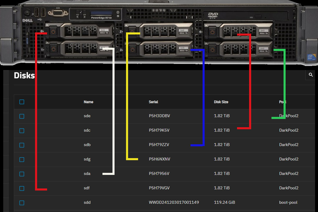

I just took down one of my TrueNas to check out the disk layout.
Posting this here for anyone that may have a similar disk layout like this DELL system.
Matched the Serial Numbers shown in Disks of TrueNas to the Physical Disk
In the R710 Server. This is NOT matching the Disk ids, but the Serial Numbers.
Dell R710 Server - 6 Bay.
Thank you, that is considerate of you.
Unfortunately the specific links are not going to be of much use for anyone else because they don’t have your specific system and serial numbers.
The device names on the left can and do change every time you reboot.
P5H3DDBV was called sde when you took that screenshot but may not be anymore.
The idea of recording how physical placement correspond with serial numbers in your own setup however, THAT is useful, and is what the OP should have done. Kudos for thinking ahead doing this.
