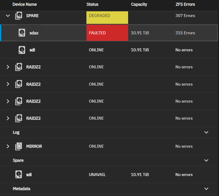

I have no idea what’s going on. I had a disk fail (sdax). I had a spare in the system(sdi).
both sdi and sdax are now listed in one of my vdevs, but sdi is still listed in spare as well. However the system reports I have an unused disk sdax…so they are both spares and in the vdev? The vdev is still listed as degraded, however its 11 wide and with sdi in there it should be whole. I don’t know what my next steps are.
The spare (sdi) has done its job and although still listed as a spare it’s crucially ‘unavailable’ as it’s now a pool member proper. The pool is still degraded as you no longer have an available spare.
The original disk (sdax) was faulted by TrueNAS for some reason often because its producing too many errors or not responding in good time.
Next steps are to replace the failed drive (sdax) NOT the spare. Once resilver is complete the spare should automatically return to being a spare again.
Sdax is not a spare.

That is correct if you want the Hot Spare (sdi) to permanently replace the failed drive.
If you want the Hot Spare (sdi) to go back to being a Hot Spare, then what @Johnny_Fartpants said is correct.
See Replacing Disks | TrueNAS Documentation Hub for a discussion of both approaches.
Or to confirm the temporary replacement and make sdi a permanent pool member. The you can bring in a new spare.
Both options are fine. :slight_smile:
thanks for all the help. I am so used to raid systems automatically kicking a drive out and replacing it. I have detached the failed drive (sdax) and everything went green.
I will head out there later today and replace the drive.
From what I understand now, I technically want in a degraded state as all drives in the array were there, but it was reporting because my spare was now missing, as it had been assigned? In other words, I still had the full 2 parity drives in my Z2 vdev, even though it was complaining?
Yep you got it.
