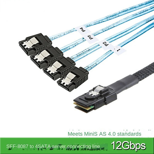

There are sas to sata breakout cables like this one
Got it thank you I was wondering, appreciated

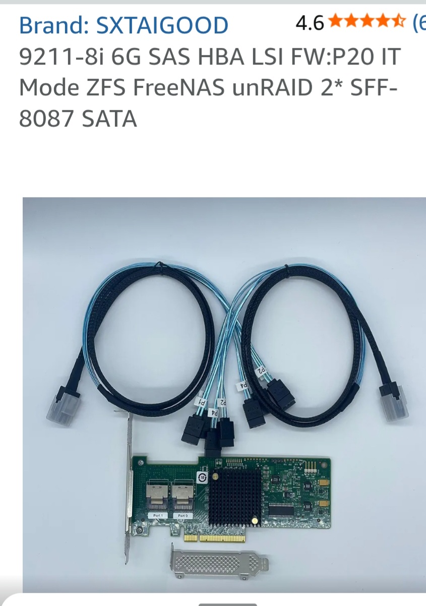

I didn’t get it the exact card I picked one up from Amazon. My hard drives are internal
This is what I’m getting
Alright.
Good luck.
Thank you brother
That’s for 8 drives, is that enough?
Art
His motherboard has a SATA controller made by Intel, but since no board name has been mentioned no one really knows what the OPs board is capable of. If the board has at least 2 ports going to that controller, it would be enough for the OPs 9 drives + an OS drive.
