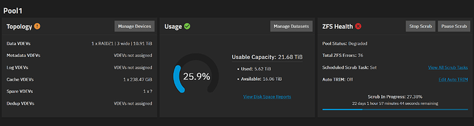

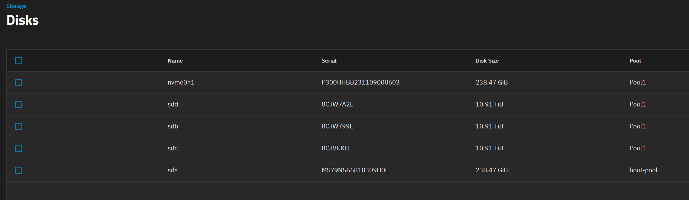

After shutting down, reseating cables, and powering up again, The storage dashboard looks like this:
But when I click on disks, it’s still not showing one of the original disks, serial 8CJVUKLE. It was originally set up with 4 disks.
What about zpool status -v
This shows that the drive is indeed not detected by the system.

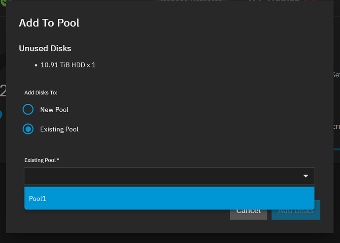

System seems to have stabilized a bit, I now see the unused drive in the GUI and have the option to add it to the pool.
I’m starting to think I had two drives go, not just one.

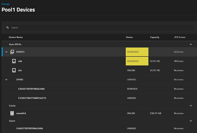

It look like neither one of the drives listed as “spare” are there, according to the lsblk data, and drive sdd now is not assigned to any pool.
You need to REPLACE the spare2 drive.
Try this: (all based on your last lsblk output)
  1. In the TrueNAS GUI Select → Storage → Manage Devices → Click on the dropdown to expand the list of assigned drives.
  2. What does this show?
  3. If you see more than drives sdb, sdc, nvme0n1 (based on your last lsblk output) then those extra drives I think you should click on it, then select REPLACE if it is available. Then select your new drive sdd.
    If this doesn’t work, post the screen capture of this so we can see. What I fear is you will need to manually replace the drive via CLI. It isn’t difficult, I just prefer the GUI if it works.
Let us know.
P.S. Do you have a backup of any important data? I’ve been all over the place this morning so I don’t recall if you stated this.
Here’s the Manage Devices as it stands.
