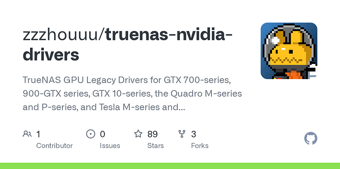

So - I hope that a minor point backport or whatever it is called will be released because I am now “stuck” on 25.04.2.6 until such a time as I can afford a new graphics card. But, thanks to @Lycestra I was able to implement that local fix and I have done an init script (with help from AI to explain where to find it and implement it) which will keep me “safe” when I occasionally reboot even if TN don’t up-issue.

so if I can summon up the courage, it appears that there’s a way for me to upgrade TN to the latest version whilst maintaining compatibility with older Nvidia drivers (which might include my P620).
