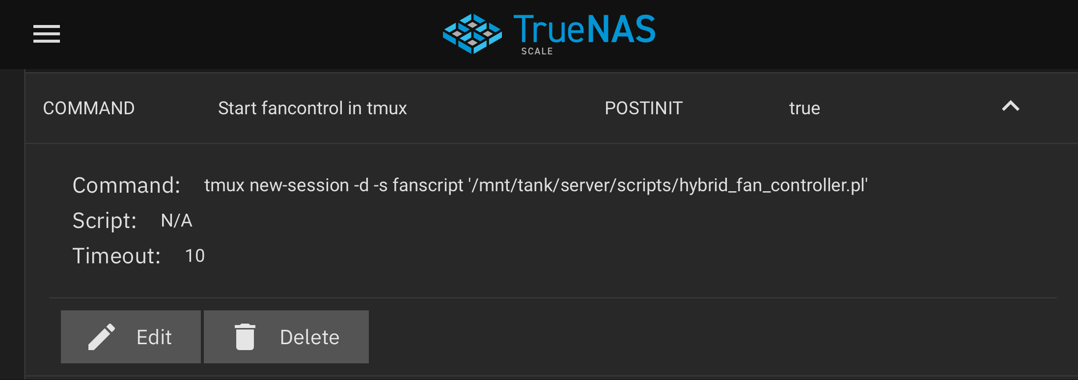

Back to your script. In what environment is this script intended to run? TrueNAS? Shell not GUI (what I read says avoid the Shell in GUI)? Or on a separate Linux box? I’m woefully ignorant about running scripts in a Linux environment. But I’d really like to test my HGST drives thoroughly. Any guidance appreciated. The Linux Literate tend to assume others are (or should be). Fair enough, but getting there is like drinking from a fire hydrant. Many thanks.
The script is typically launched at startup directly by TrueNAS.
It is also used by people not using TrueNAS.

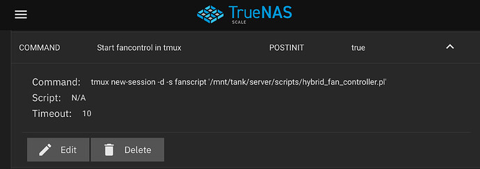

Anyway, in the TrueNAS case, launch the script inside a tmux process which is launched using a post-init command task from TrueNAS
Actual production example:
The tmux process protects the script from middlewared crashing, and allows you the admin, to connect to the running version of the script to observe its output, or reconfigure it.
Once configured properly your fans would be running at 100% until TrueNAS finishes booting and the script takes over fan control.
