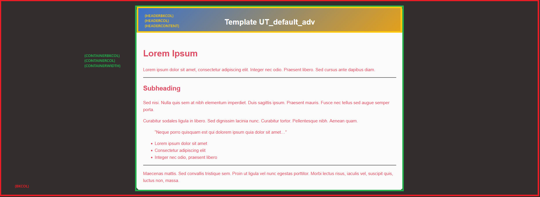

Instead this is an example of how can appear an email using the builtin UT_default_adv template:
colors used here are terrible :clown_face: but you can change them easily
--use_template "UT_default_adv" --template_var '{"bkcol": "#332D2D", "containerbkcol": "#FBFBFB", "containerwidth": "50%", "headerbkcol": "#3B71CA,#E4A11B", "containercol": "#DC4C64", "headercol": "#FFFFFF", "headercontent": "Template UT_default_adv"}'
the content (the lorem ipsum) will be your output.
