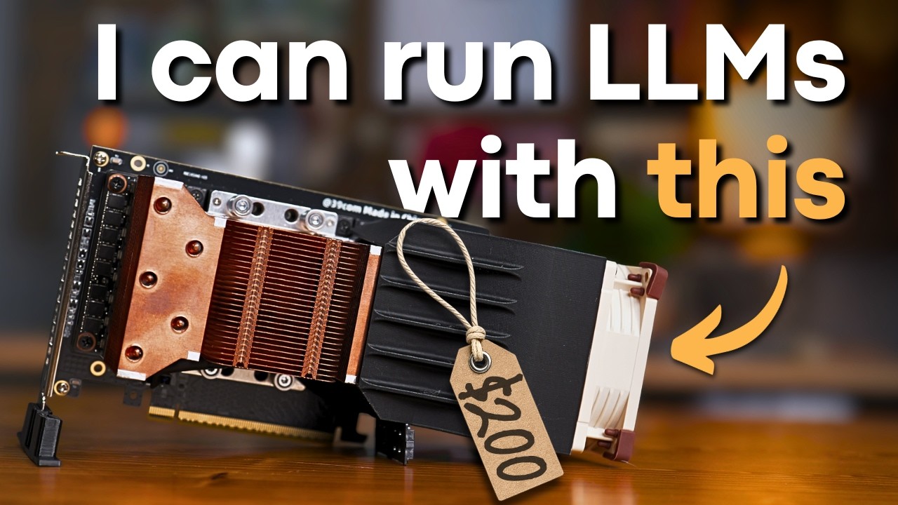

Well, the YT algorithm recommended this video:
…and before I knew it I’d ordered a 16 GB V100 with the SXM2 interface–US$100 shipped. Now to see about making it work…
Just make sure you’re runing smaller models that will fit in 16GB of memory or your experience will be frustrating at best.
No doubt. I’m wondering if I need the fan shroud and fan shown in that video–it’ll be going in a Supermicro rack chassis with the stock fans, so I’d expect pretty good airflow. Some testing might be in order.
I would think worse case scenario some ducting to direct airflow would be all you would need. That’s just a guess though.

It sounds as though the V100 is an older model (I think the video I linked indicates it came out in 2017), so I’ll be interested to see if it even works with TrueNAS. If not, I have another system I can put it in, but as I run most of my apps on my NAS I’d just as soon have it there.
older than this old model i mean :smiley: so the risk to spend less but gain poor is high.
I should have given more thought to this issue:
Yep, it’s a full-height card, and I only have room for half-height. Bother. And while there are right-angle adapters, there just isn’t enough room to lay this thing sideways, with the other cards I already have installed. Try to put it somewhere else (my Dell 7820 will take full-height cards)? Get an Oculink adapter to put it outside? And then there’s the issue of power. Hmmm…
