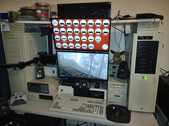

This photo was taken before the change, but looks close enough to my current setup.
The tower on the right holds a Super Micro X10SRH-CF motherboard with integrated LSI SAS 12Gb/s controller. The controller’s ports are connected to an Adaptec 82885T expander, which connects to a pair of Rosewill “RSV-SATA-Cage-34” 4-in-3 SAS/SATA hot swap cages using 3-foot cables.
