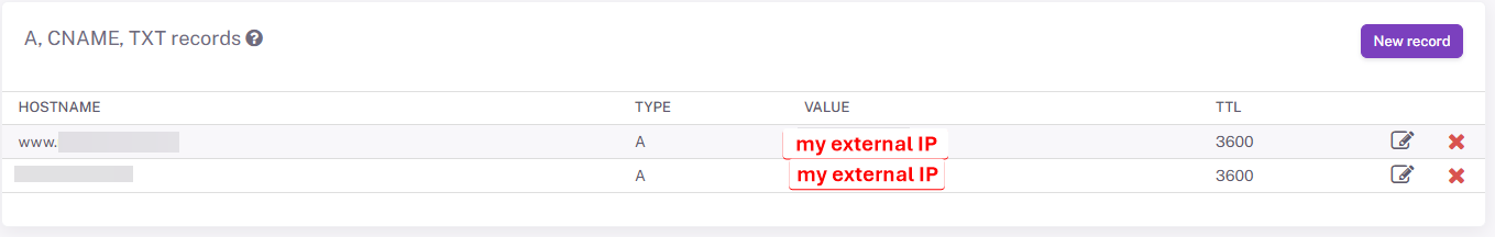

  1. Bought a domain name from a local registrar. Next to the CNAME record, there is the default IP address (don’t know if that should be altered, I assume, its their IP). The provider doesn’t seem to have DDNS service, so I used Dynu.com’s with my own domain name.
    I installed DDNS updater application on TrueNAS with my domain name through Dynu. Although the updater itself says on the webUI success, the application status keeps displaying “deploying”.

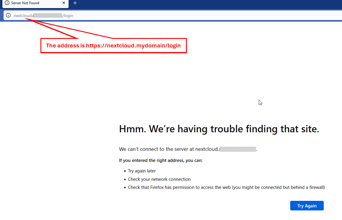

  6. Nginx Proxy manager: created a proxy host for Nextcloud. Domain name: nextcloud.mydomain. As I installed Nextcloud with certificate, I chose https and forward port 30027 (nextcloud default port). The SSL certificate is the one from earlier with *.mydomain and mydomain and ForceSSL, etc turned ON. The status is online and the SSL certificate is in use. Do I need to download and import it to the TrueNAS certificates?
When I open the application URL, loads http://nextcloud.mydomain and the error is the website cannot be reached.
Am I missing something here? I have tried to follow the advise I was given but I might be dummy.

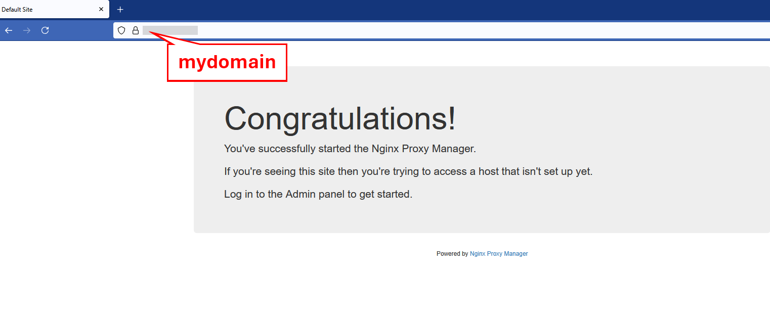

When I open mydomain in a browser:

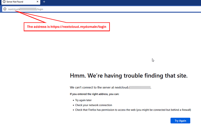

But when I click on the WebUI link on Nextcloud I’m still getting this:

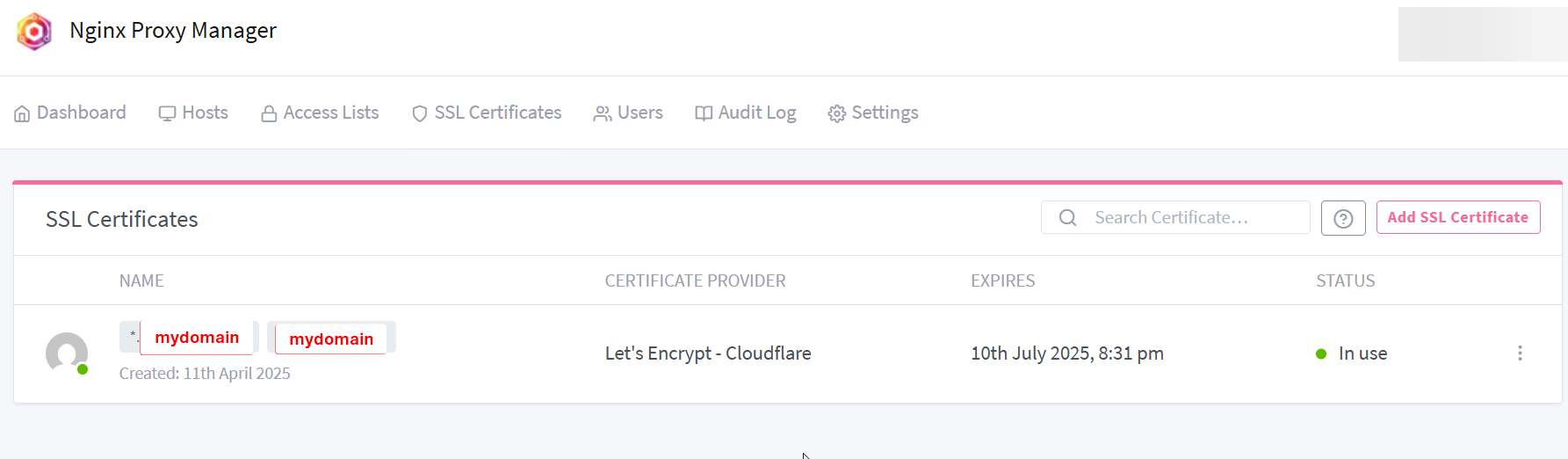

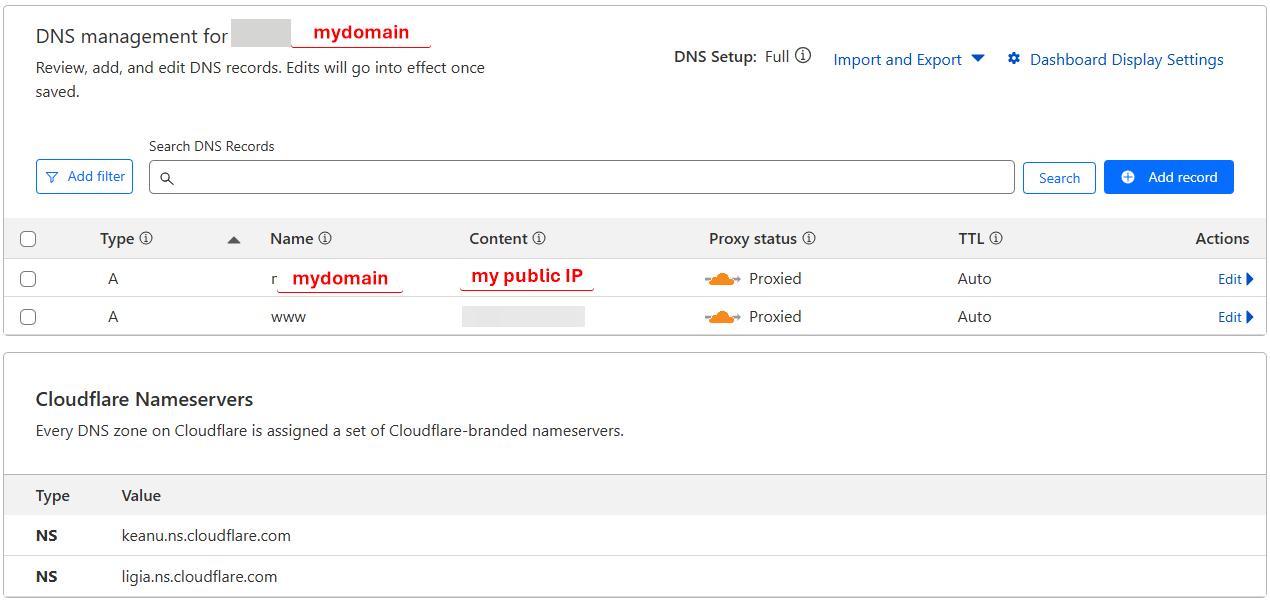

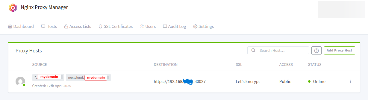

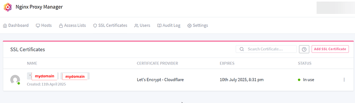

My settings in Ngnix are these:
Nextcloud got installed with the hostname: nextcloud.mydomain and with ‘truenas_default’ Certificate

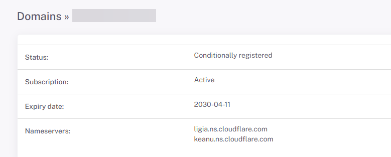

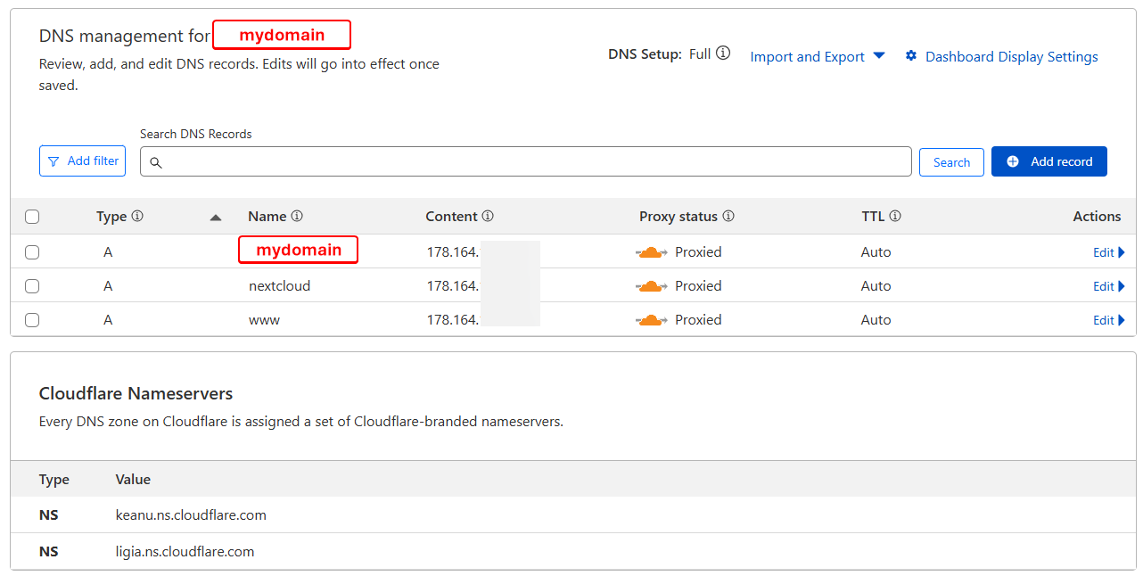

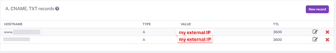

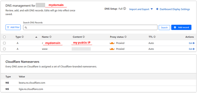

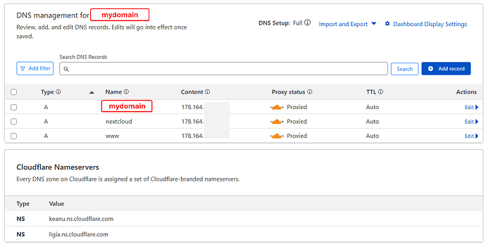

And these are the settings with my domain registrar:

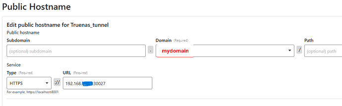

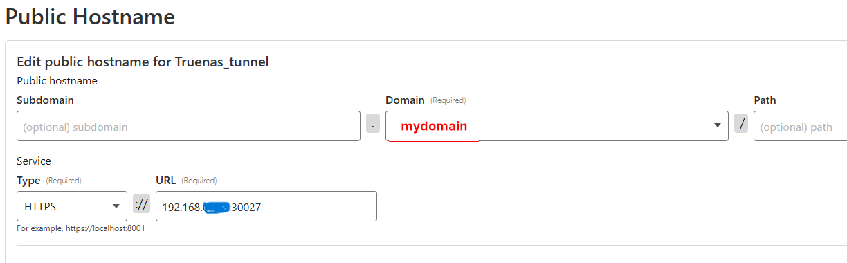

Cloudflare settings for domain and tunnel:
Here at the public hostname section it does not let me set subdomain to nextcloud.
What’s wrong with what I’m doing?

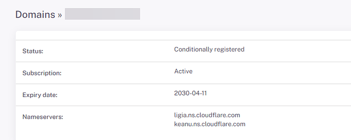

I have had already changed my nameservers on my registrar’s page to the ones to use Cloudflare:
If this is not enough then, I’ll initiate the transfer to Cloudflare. I assumed with DNS setup showing full as on the screenshots that my setup is complete.

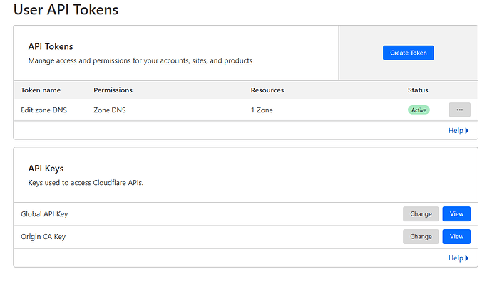

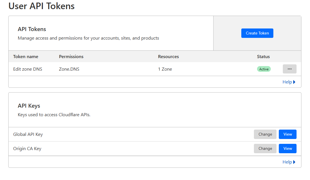

I also created the token somehow like this in this guide:
The status of the Token is like this:

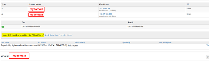

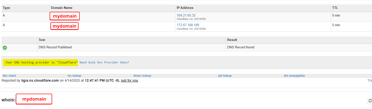

I have checked my domain name with Network Tools: DNS,IP,Email and it reports that my DNS hosting provider is Cloudflare.
Is that enough for moving forward or should I request a domain name transfer?
With the above settings I managed to get to the point where my browser displays the following:
The connection type displays as secure, at least!
So, I assume the connection from outside should work properly and the problem now is inside at least from the error code 522.
My Ngnix Proxy Manager settings are the followings:
Proxy host:
- domain names: *.mydomain, mydomain, nextcloud.mydomain
- scheme: https; server ip; 30027 (nextcloud port)
- only block common exploits is turned on
- SSL certificate: *.mydomain, mydomain
- all the settings turned on: force SSL, HTTP/2 support, HSTS enabled, HSTS subdomains
- Status is Online, access: public
SSL certificates:
- Let’s Encrypt certificate is setup with cloudflare token with the domain names: *.mydomain, mydomain and the certificate’s status shows “in use”.

Domain from a registrar but managed on Cludflare:
DNSSec not enabled
Mydomain is using automatic SSL/TLS. Encryption mode is set to Cloudflare’s recommendation.
I have created a Cloudflare tunnel to TrueNAS - status healty
Public hostname: (NO subdomain) - mydomain
Service: HTTPS://192.168.x.x:30022 - Ngnix port for 443 (tried also with Nextcloud port: 30027)

    SSL certificate:
  • Let’s Encrypt certificate is setup with Cloudflare token (DNS challenge) with the domain names: *.mydomain, mydomain and the certificate’s status shows “in use”.

    When I don’t set the hostname, then Nextcloud is available from LAN but not from the internet. I tried with different installation versions but without luck.
    Generally I receive the following error, at least when tried with https then it does not display “insecure connection”:
Please help me further, I’m stuck.
