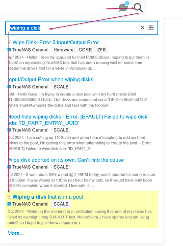

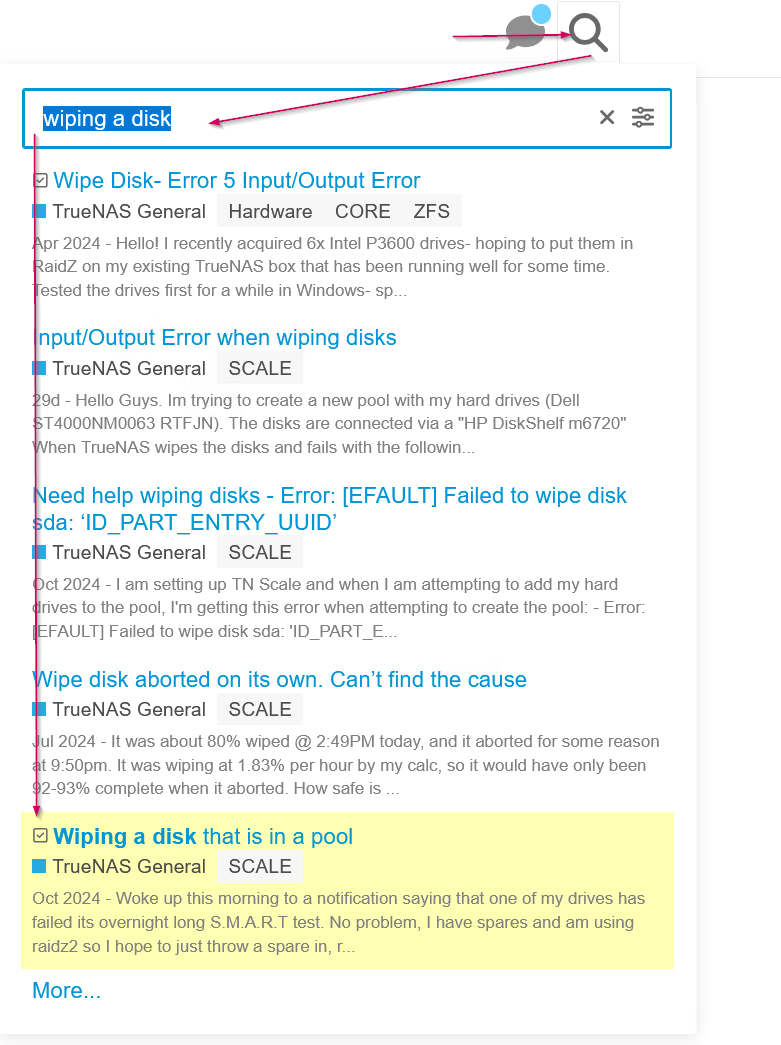

These should give you a start:
I suggest going through the additional search results on the wipe as sometimes the wipe might not succeed in some cases.
If you are worried about sending a non-wiped disk to RMA, yes your concern is valid - but when the disk does not execute commands there are only a few things that can be done to destroy the data. So next time may be consider encrypting the new disk in the beginning itself if you are worried about the data sensitivity.
