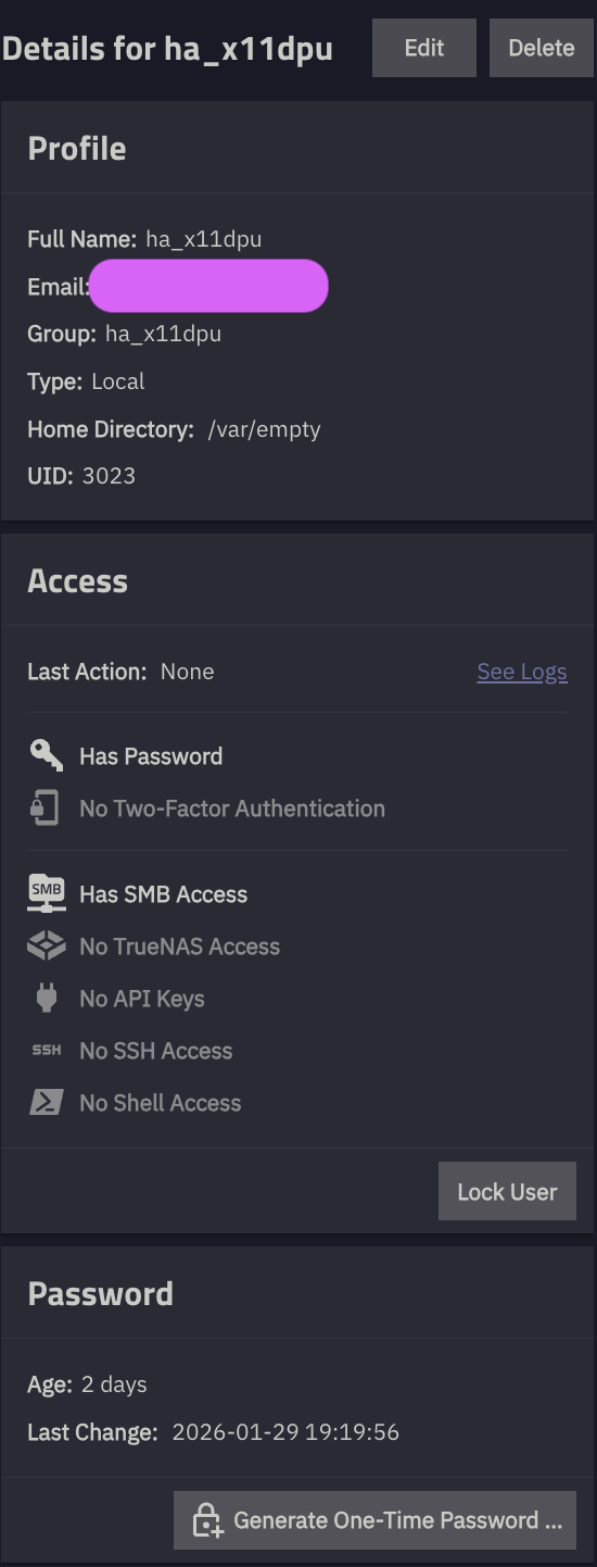

I have setup a user ha_x11dpu with SMB access like this:

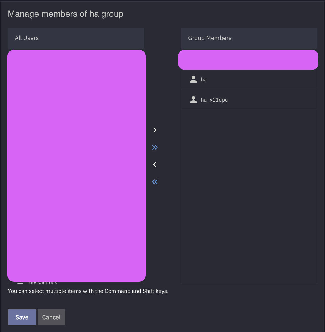

And I have add the user to ha group like this:

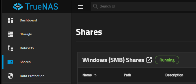

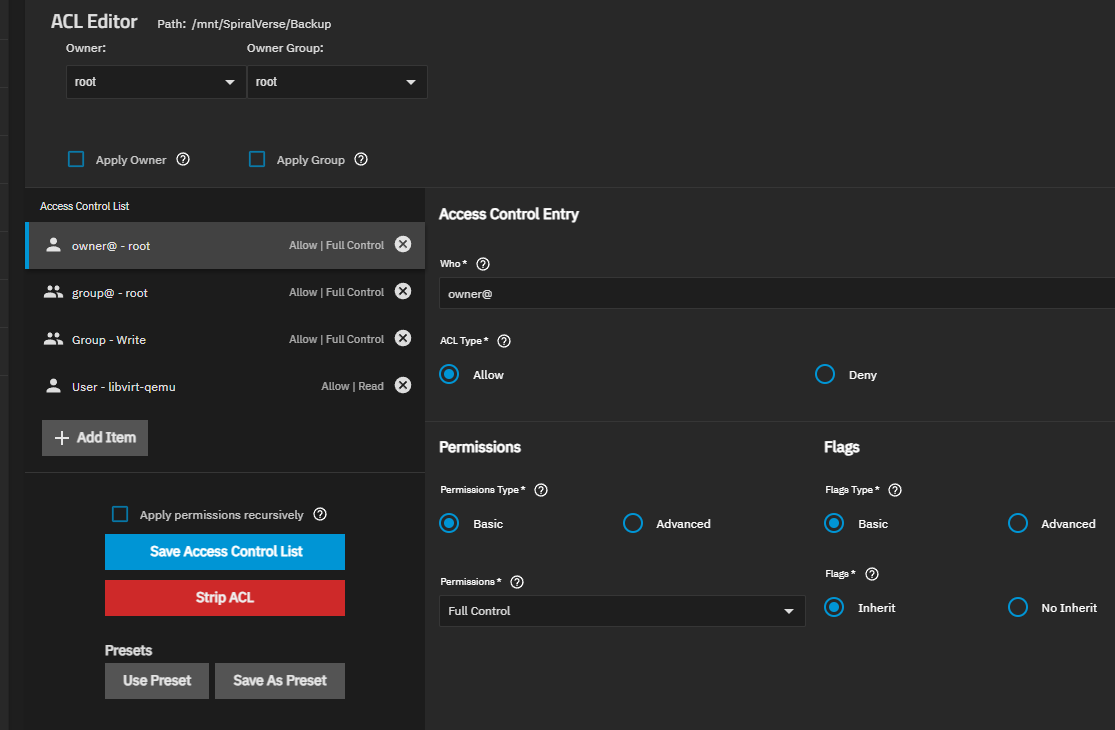

You’ll want to go to Shares, click on View All, click on the 3 dots next to your SMB share and set the ACL. I prefer the Fileystem ACL to set permissions. Make sure your group is added and configured for the proper permissions for the share, then save the ACL, wait a few seconds and test.
Thanks a ton!
You are a life saver. I didn’t know that a samba server on TrueNAS requires ACL to be enforced in order to function.
And the effect of ACL is pretty wild. I don’t understand why the ACL of a subpath affect the parent directories. I need to study more.
SMB services just makes the shares available over the protocol. ACL is the control access to the shares or permissions granted to groups/users. Generally, when you care a new SMB share, it’ll ask if you want permissions from the parent folder to apply to the new. Any new folders created by the user within the data set will inherit permissions from the parent.
Yeah. The thing I don’t understand is, the smb client logs in with a traditional group permissions to read, write and execute on the share. Yet it still throws the permission error unless I add the same permissions again in ACL.:face_with_spiral_eyes:
