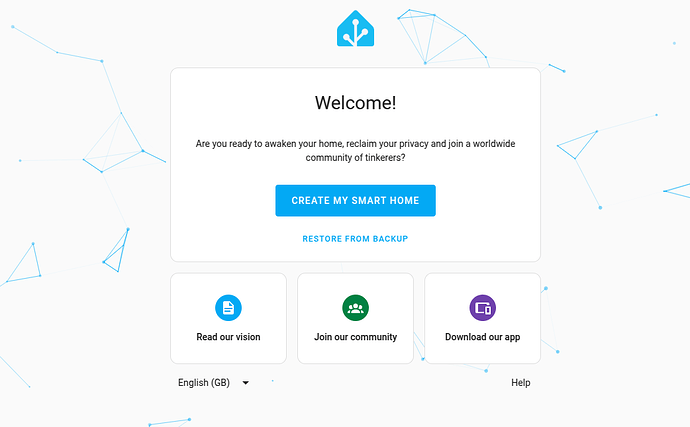

That was easier than I expected it to be:
I followed an idiot-proof guide (thank God) and only made one mistake (br0 but I decided filtering should be applied, and it shouldn’t, but then you can’t get at those settings in the VM menu so I had to delete it and create another instance).
Thanks for all of these responses, which have spurred me on to create my first ever VM within TrueNAS. The resources it is consuming, at least at the moment, are negligible.
