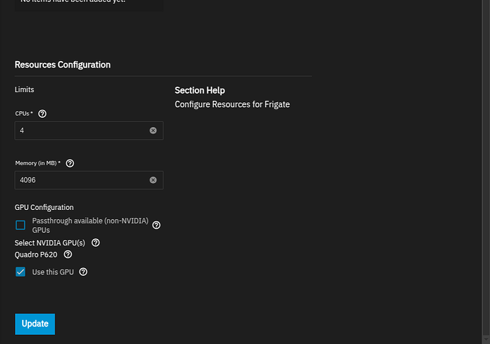

@Constantin I too have struggled ( a lot!) with setting up Frigate using the official App but I have finally succeeded and I have found Frigate to be brilliant!
The approach I used was to set up the app thus:
The host path approach means I can find where the config.yaml lives:
so when I get stuck with a config which is ruined, I can manually delete/edit etc. at that location.

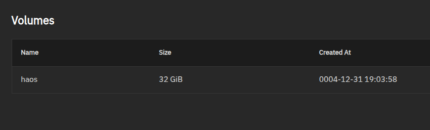

When I imported my zvol, I used the clone option. The following window popped up. Before hitting select, confirm your zvol is showing a Size of at least 32 GiB

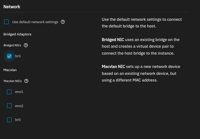

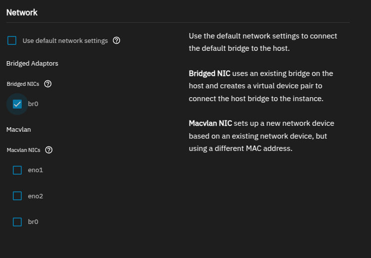

Under the Network section, I uncheck Use default network settings and then select the bridge I had created on TrueNAS

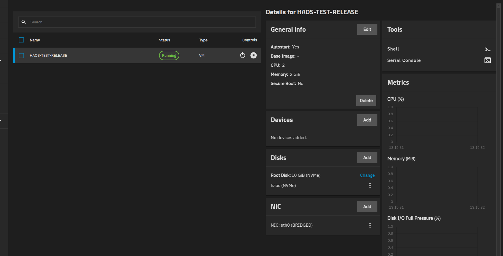

After I finished creating the VM, it started automagically.

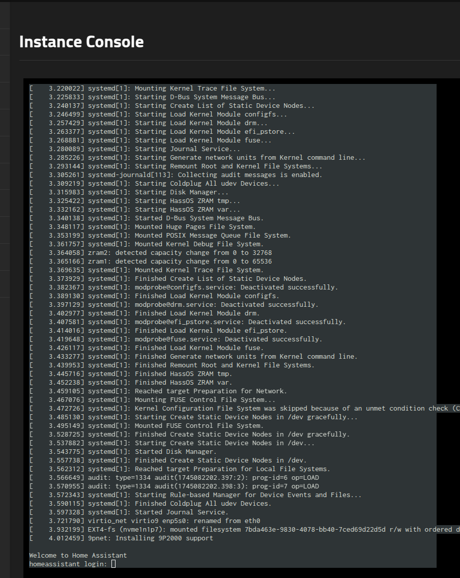

I quickly pressed the Serial Console under Tools and was able to watch the VM boot up. There was a long pause at the line Installing SP2000 support, but the message Welcome to Home Assistant eventually appeared.

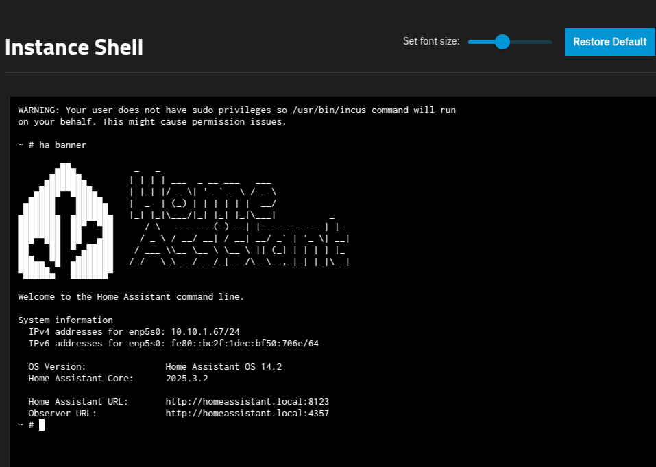

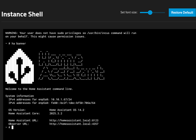

At this point, I closed the Instance Console and clicked Shell
In the Instance Shell, I typed ha banner then looked under System Information and was able to verify the VM has a valid IP address.

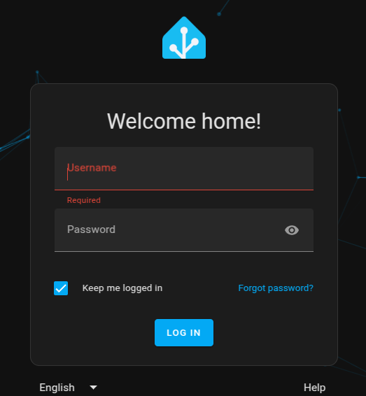

For this example, I enter 10.10.1.67:8123 into my web browser and reach the HA login screen
Hopefully, some of that helps get you going, or at least helps to figure out what is wrong
