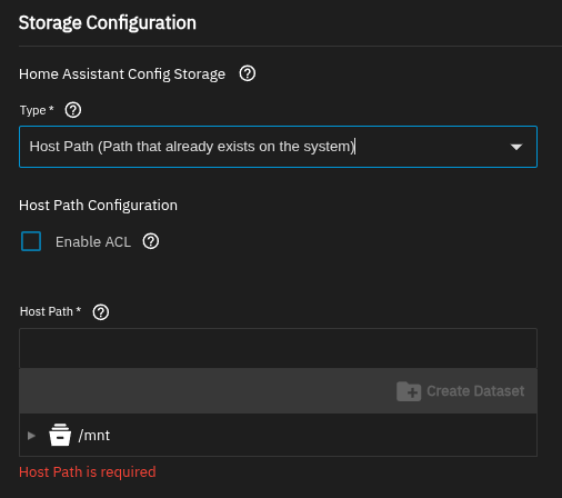

It is setup with an IXvolume. I am guessing I’ll need to set it up again with a Host path for Home Assistant?
Given Home Assistant’s built-in backup / restore functionality, it may be the easiest way to go. (or start again from scratch)
Alternatively, you can search the TrueNAS forums for how to migrate the application’s ixvolume to a host past.
