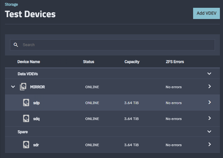

I have been reading about hot spares and would like to add them to my main and backup pools (I am pretty sure I have the hardware to support this). My main pool is RAIDZ2 | 8 wide and my backup is RAIDZ1 | 4 wide. I have been experimenting with creating a new pool (Test) and I have the ability to create a data VDEV and a Spare VDEV … here is a screen shot.
pic of VDEVs
Next … I trashed the Test pool and recreated it with just a mirrored data VDEV. After creating the pool, I added a spare VDEV. The pic of the VDEVs was exactly the same as above.
So … Q: Is the end result (data VDEV and Spare VDEV) the same if I create the spare when I create the pool or add the spare afterwards?
Same
