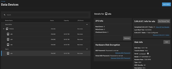

I setup a spare HDD of the same size as the other 3 HDD in my RAIDZ1. I was getting errors from the SMART tests and when I ran them manually for any of the testing types. They all would fail (every SMART test). I no longer wanted to wait for the drive to fail, but I started finding the docs as well as the method to offline the failing drive and how to replace with the spare. The device I placed into spare, was a single device. It shows it as a spare vdev. Did I place the spare drive in the wrong place for it to pull the hot spare into the vdev after taking the drive offline?
I was able to remove it from the space on the VDEV and put it into a standalone device. Forcing the offline device to be replaced by the now spare device available to replace the offline device. It is now working to re-write the data from the missing HDD offline. I have things up and going and will order a replacement while I figure out what the status of the drive offline. Data is safe but have two similar TrueNAS setups and want to fix the configs on the other system that is not seeing a drive issue. It however will need me to react to fix a failed drive instead of the NAS system to replace the failed drive in the system.
I’m not positive however I think your drive needs to fail a SCRUB for the spare to be called into service.
As a side note, if you are going to have an active spare, why not just create a RAIDZ2, this way you already have the built in redundancy. Just a thought. I know some people would rather not go that route, which is perfectly fine.
@joeschmuck - Thank you for the info. I’ll look into the RAIDZ2. The main reason I was looking for it to be hot spare is if another device; EG the camera NVR I could remove it from the NAS while I protect the RAID in NVR. Not likely that a healthy RAIDZ1 would fail before the hot spare would be replaced. I read that forcing it offline would pull it in, but I might have been wrong. Below is the links and how I thought it would force it to start.
