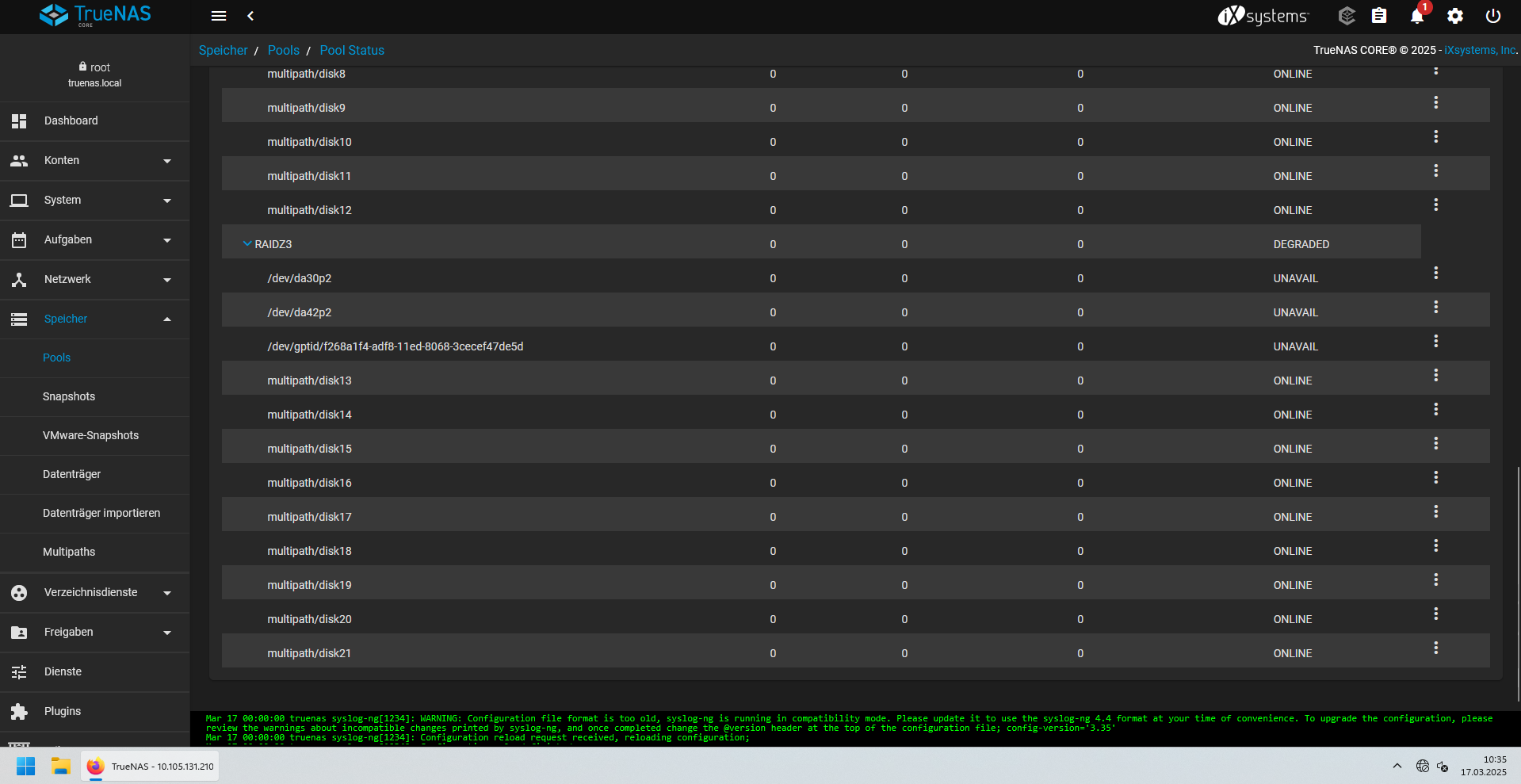

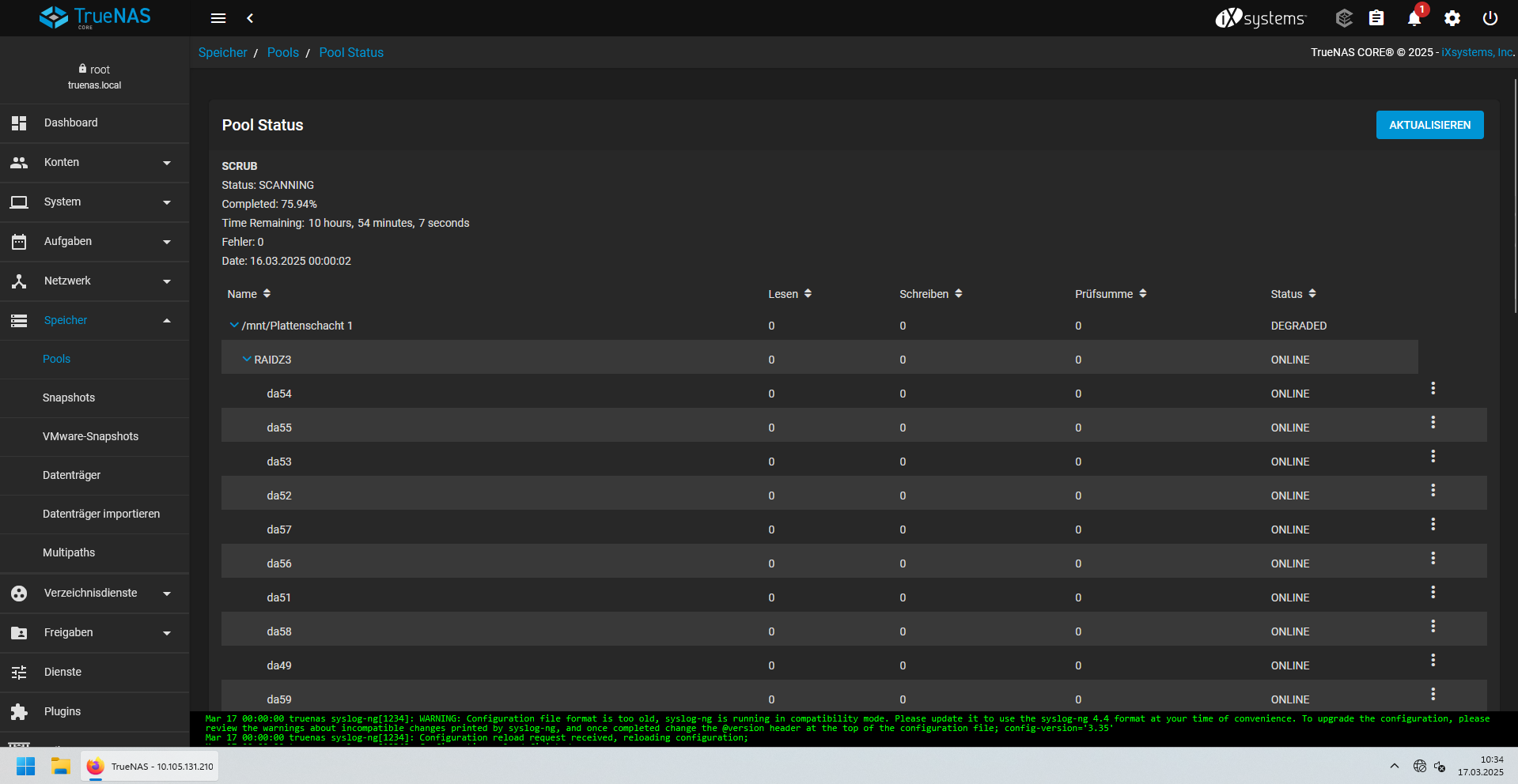

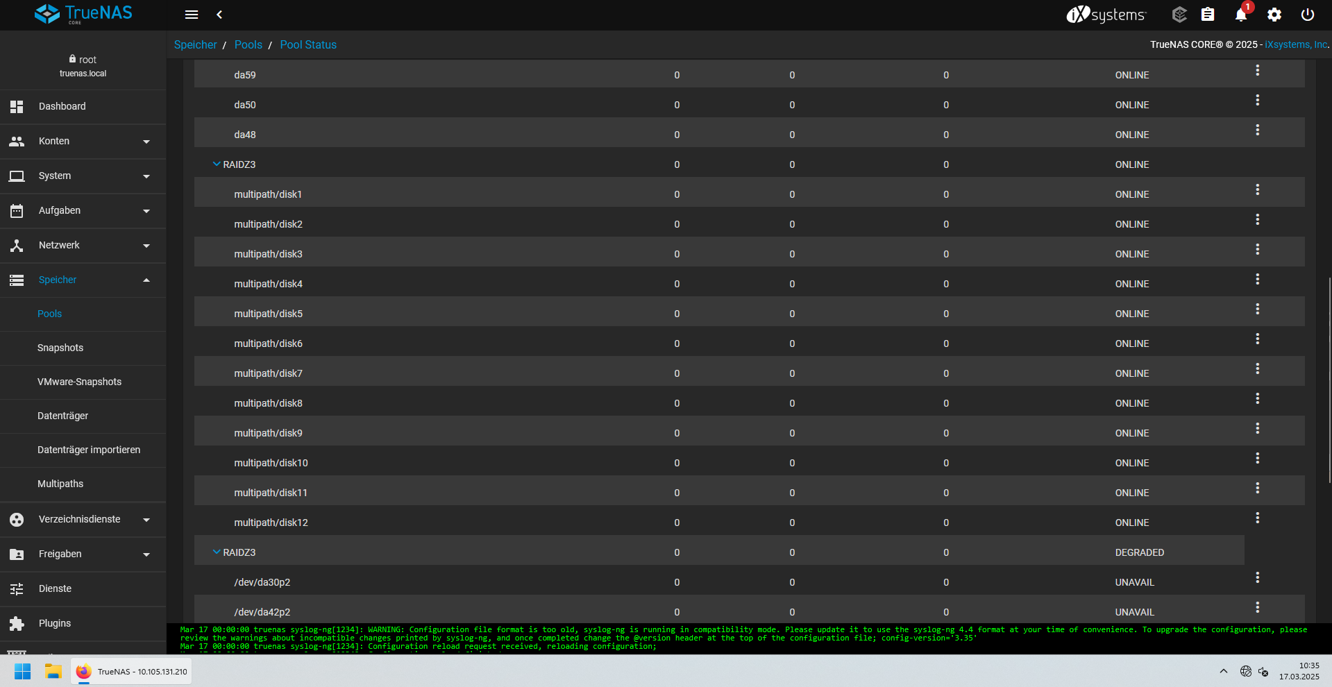

Can you also share a screenshot of the TrueNAS UI showing essentially zpool status. Storage, Pools, cog wheel - Status.
Hi there, this is one of our Multipath problems… those disks went unavailable in the second we upgraded from 13.0 U6.7 to 13.10 U1.1. That is our 2nd Problem - we want to reintegrate/fix those disks, because they are not dead at all. We don´t know why they became unavailable.

Im not understanding the multipath issue you mention as all your drives are SATA and not capable of multipath. Also you say the JBODs are only cabled to the HBAs via a single cable making multipath impossible. A screenshot of the UI as mentioned above may help shed some more light.
