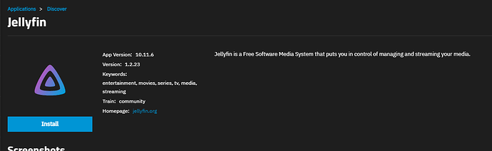

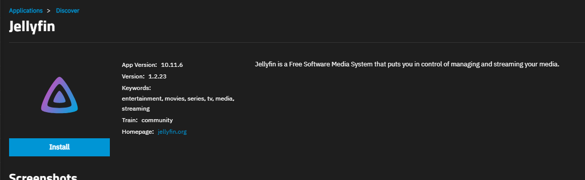

I’m on 25.04 (the current stable train), and the catalougue show is available
