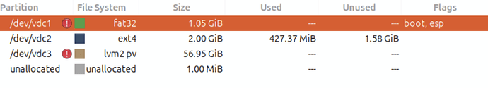

First step is start gparted. Here the main disk of the VM to repair.

sudo mount /dev/vdc3 /mnt/vmname => unkown file system => did now work

I suppose /dev/vdc3 is the base of the Ubuntu to repair, but not 100% sure there
/dev/vdc3 is not a a file system but an LVM volume group. Hope I used the right term. You need to activate lvm2 - possibly, maybe it is already - and then use some other device presented by the volume manager. I don’t know from the top of my head but that should be easy to find on stackoverflow and friends. “LVM2 mount volume”

You can use pvscan, vgscan, and lvscan to automatically find and list PVs, VGs, and LVs.
You can use vgchange -ay to activate all VGs. From here, you can mount individual filesystems that exist on the LVs. Use lvscan to know their names, and then mount them in this format:
mount /dev/<vgname>/<lvname> /mnt/ubunturoot

Were you able to mount the LV? After activating the VG, does the filesystem on the LV show up with lsblk?
lsblk -o NAME,TYPE,SIZE,PARTTYPENAME,FSTYPE
