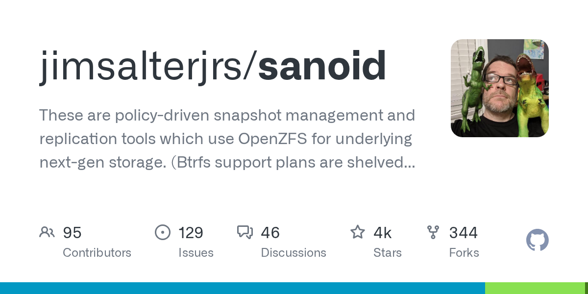

Been considering sanoid/syncoid for a long time.

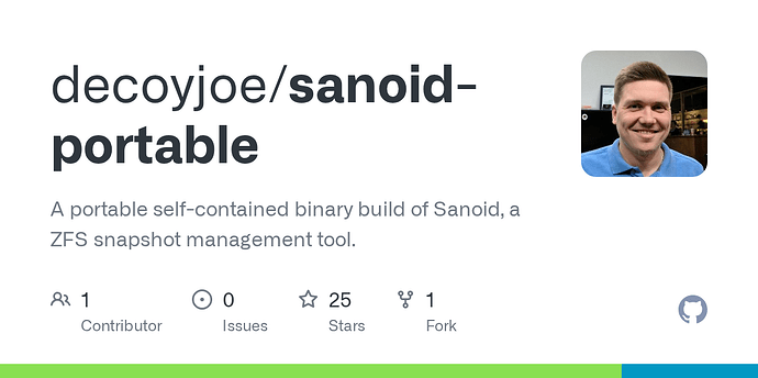

Just found sanoid portable and I will end up migrating to it, so I can have more control and options.

If sanoid was rsync based, I would not have mentioned it.
May want to inform yourself of this ZFS replication solution.
