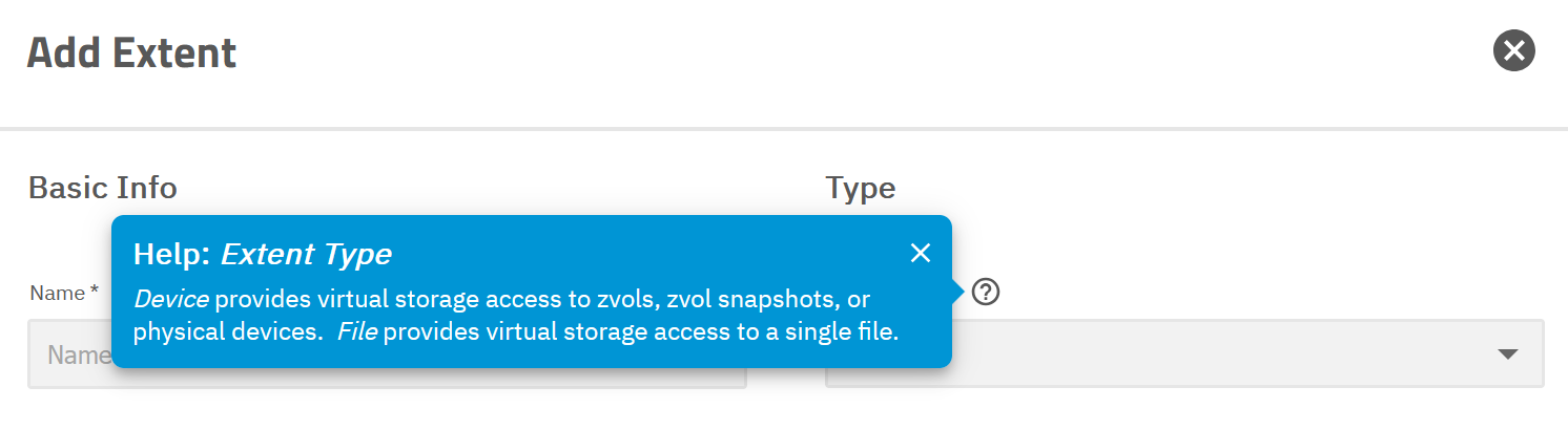

I am running 25.04.2.4 and when adding an extent, I set the Extent Type to Device, but all I see in the device list are zvols, not disk devices.
The popup help for Extent Type lead me to belive this should work, it says " *Device* provides virtual storage access to zvols, zvol snapshots, or physical devices."

The popup help in the UI to add extents says the same:

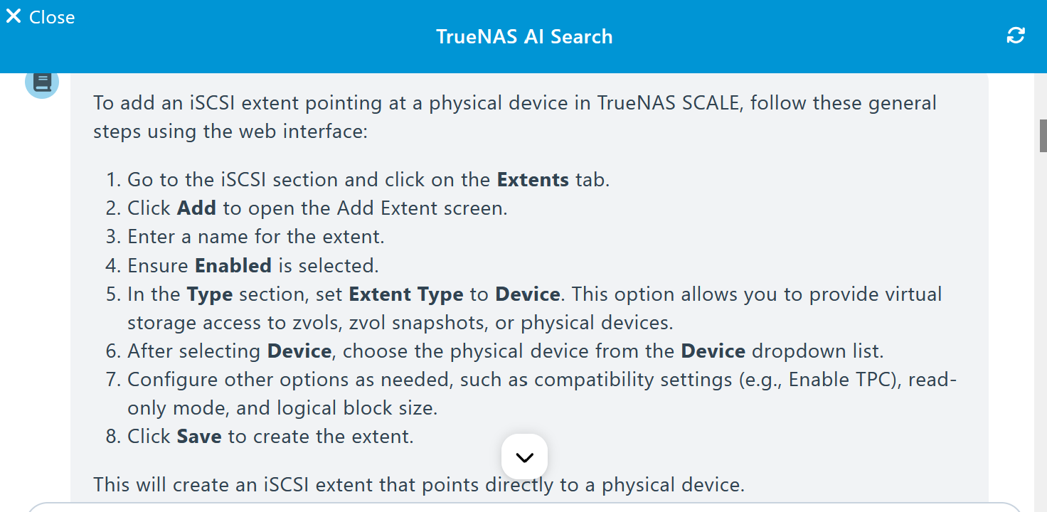

And the AI documentation search came up with step by step instructions for it:

Okay. I told the docs team and they’ll fix it. IIRC we used to allow this with some old truenas versions and the docs were apparently never updated.
I remember this being brought up on the old forums, unfortunately I cannot link it here (it was thread ID 104740). It is supported on TrueNAS Core, but not on Scale. Scale removed this for some reason.
