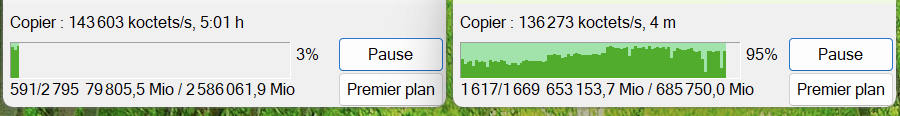

That’s really weird. I’ve been pulling from the truenas 2 x 130-140MB/s stable in parallel (I think the 2.5 Gbe is maxed out) for more than 30 minutes now and it doesn’t slow down… I still don’t get it.
