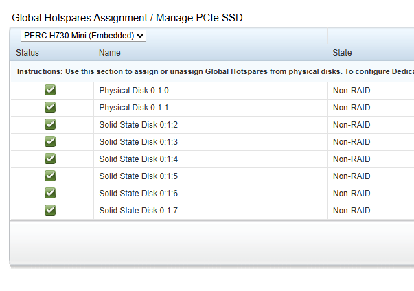

I have Truenas installed on my R430 with a a H730. and it works like a charm.
Disks configured as shown in the attached image.

The h730 works perfectly. I have a dell T330 with x8 16TB drives under TrueNAS. The h730 firmware from dell let’s you put it in hba mode and pass the disks through. Been running for years and nothing even close to an issue.
See here How To Convert RAID mode to HBA Mode on Dell PERC | Dell Serbia

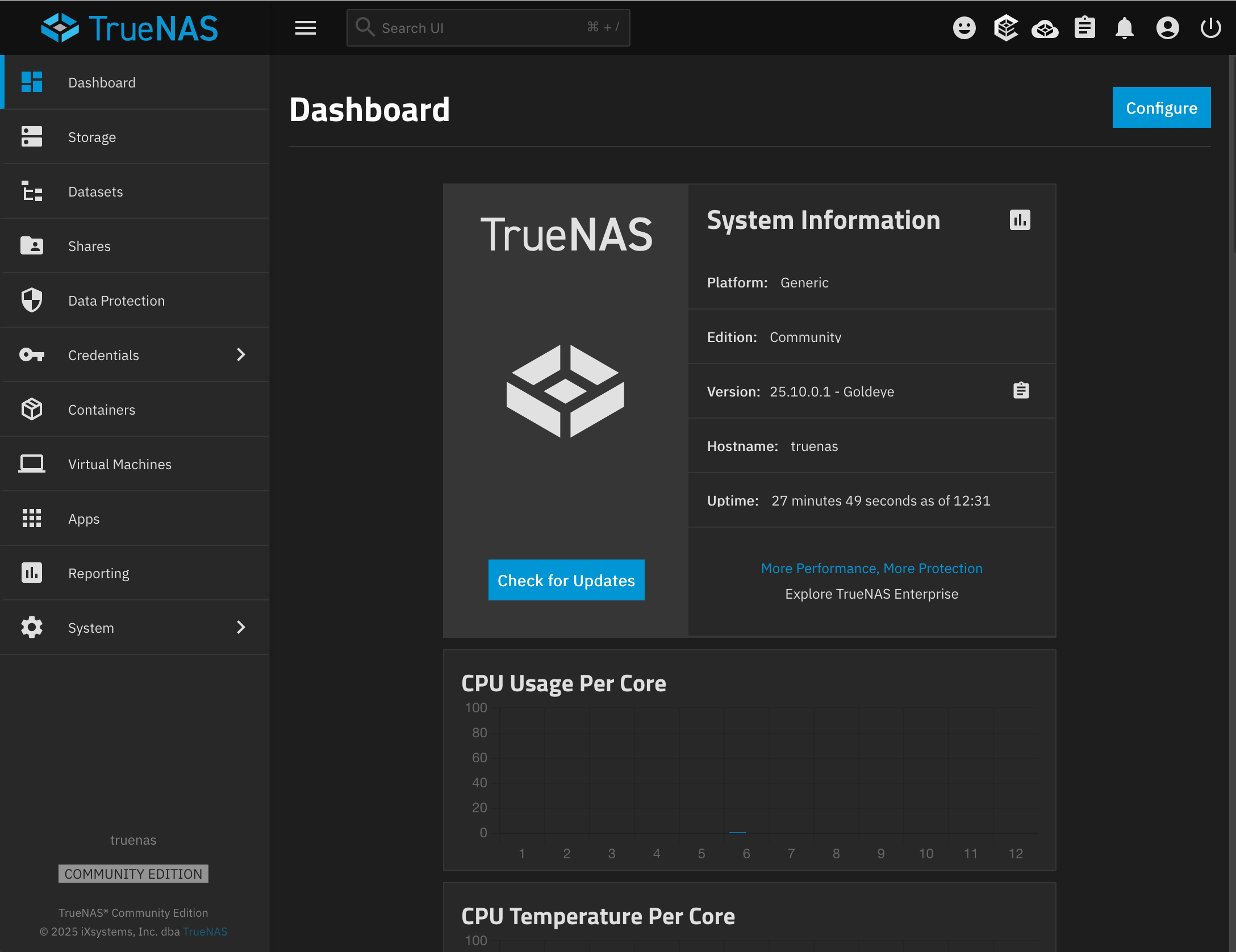

I took a leap of faith (my main form of exercise) and pulled the trigger today! Such a smooth install process!!
