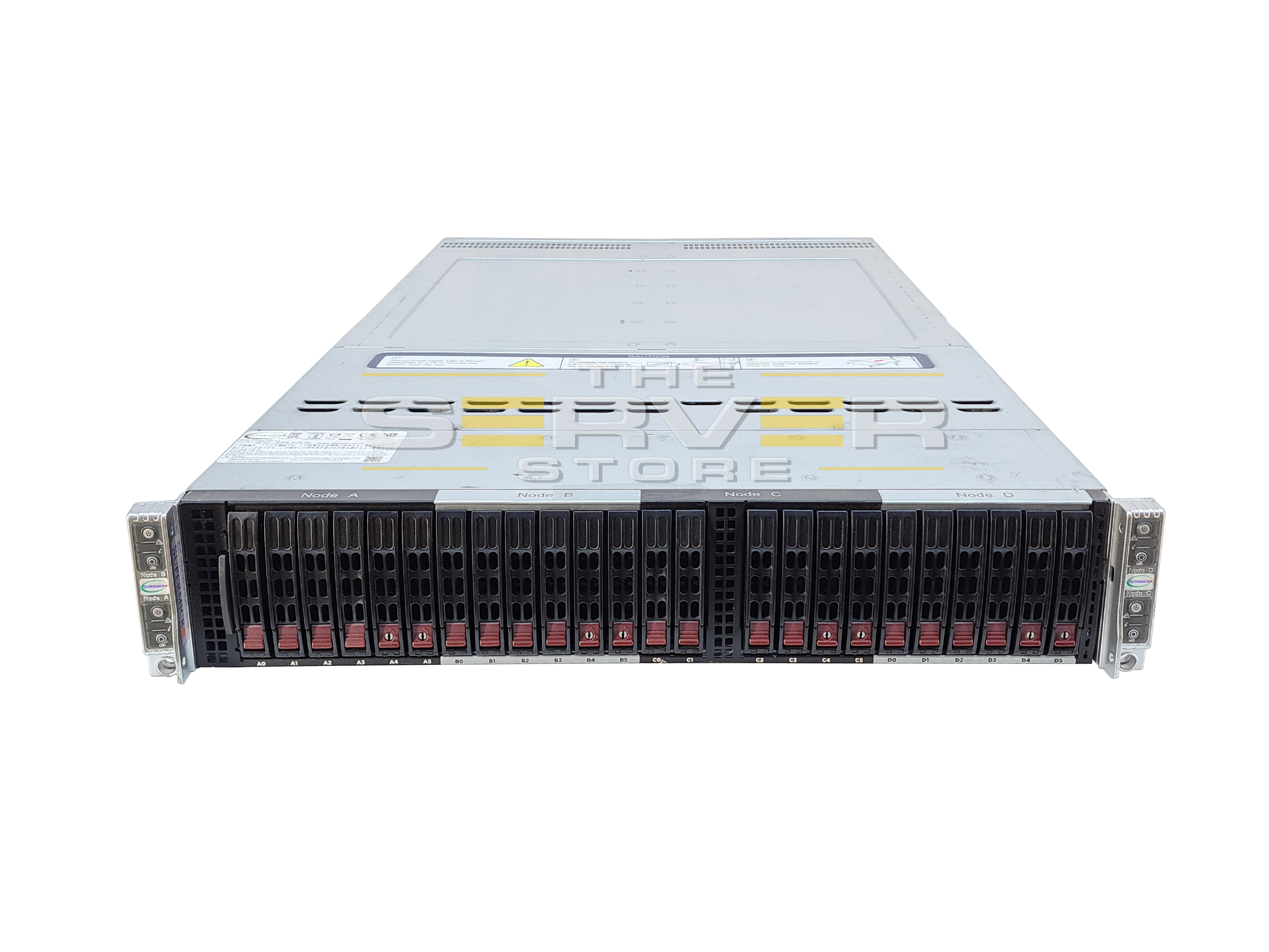

So I guess I’m looking at building a second NAS. I found this reddit post about doing so, and then from some searching found this supermicro box:
24 nvme disks would put me close to my existing NAS capacity. That’s pretty tempting right off the bat.

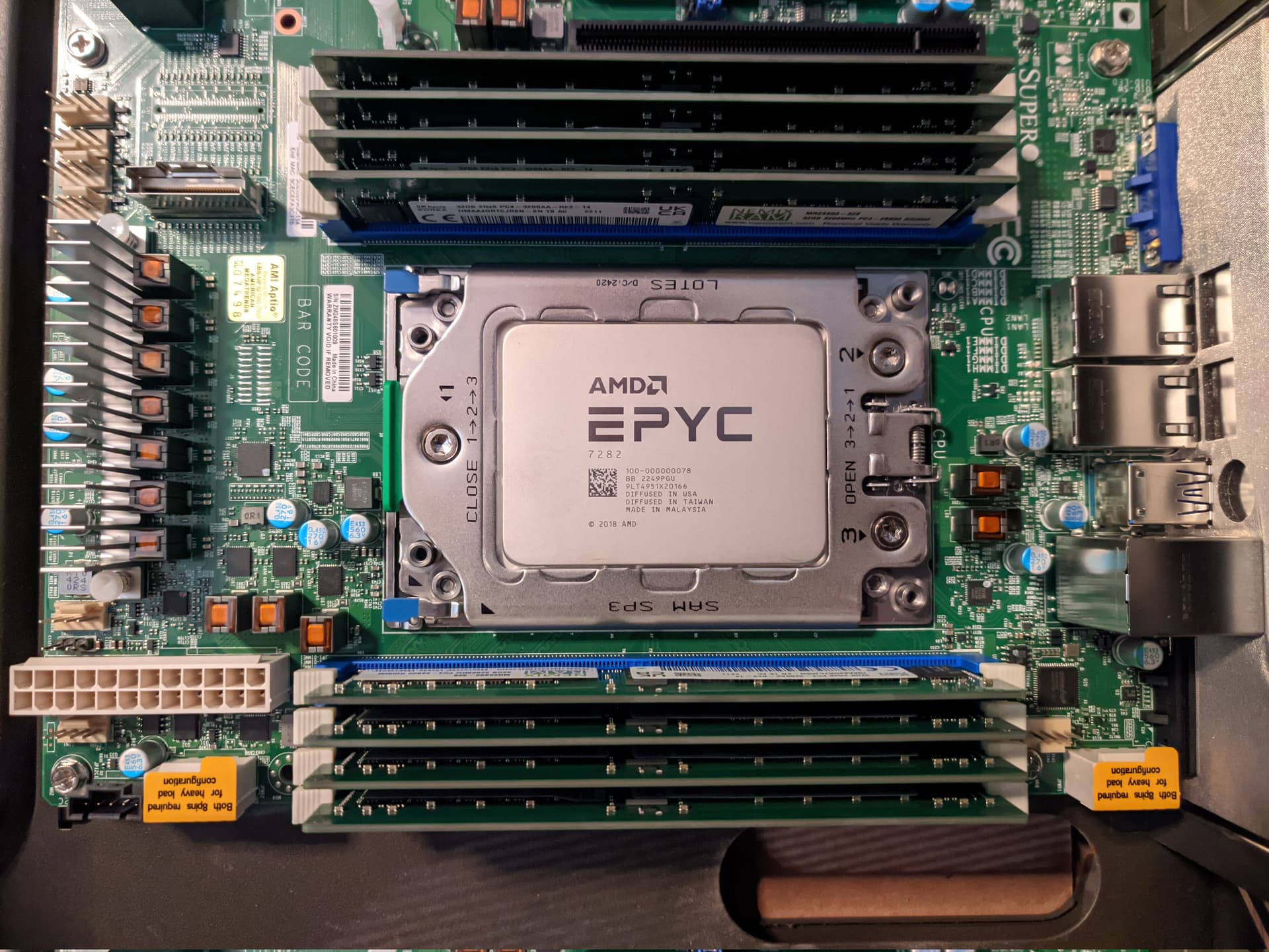

Following up here that I wound up building a new system for the drives:

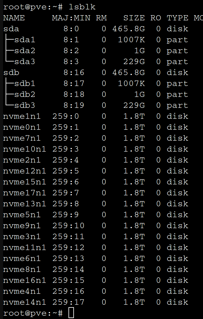

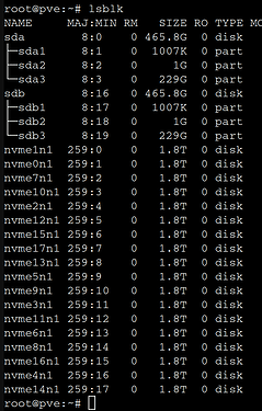

And the 18x 2TB nvme drives…

I have proxmox installed, and am trying to hunt down what filesystem layout I want to use for the drives. ZFS is appealing to be able to easily backup to my TN box, but I feel like something lighter like mdadm + xfs or ext4 would work better for all SSDs…
