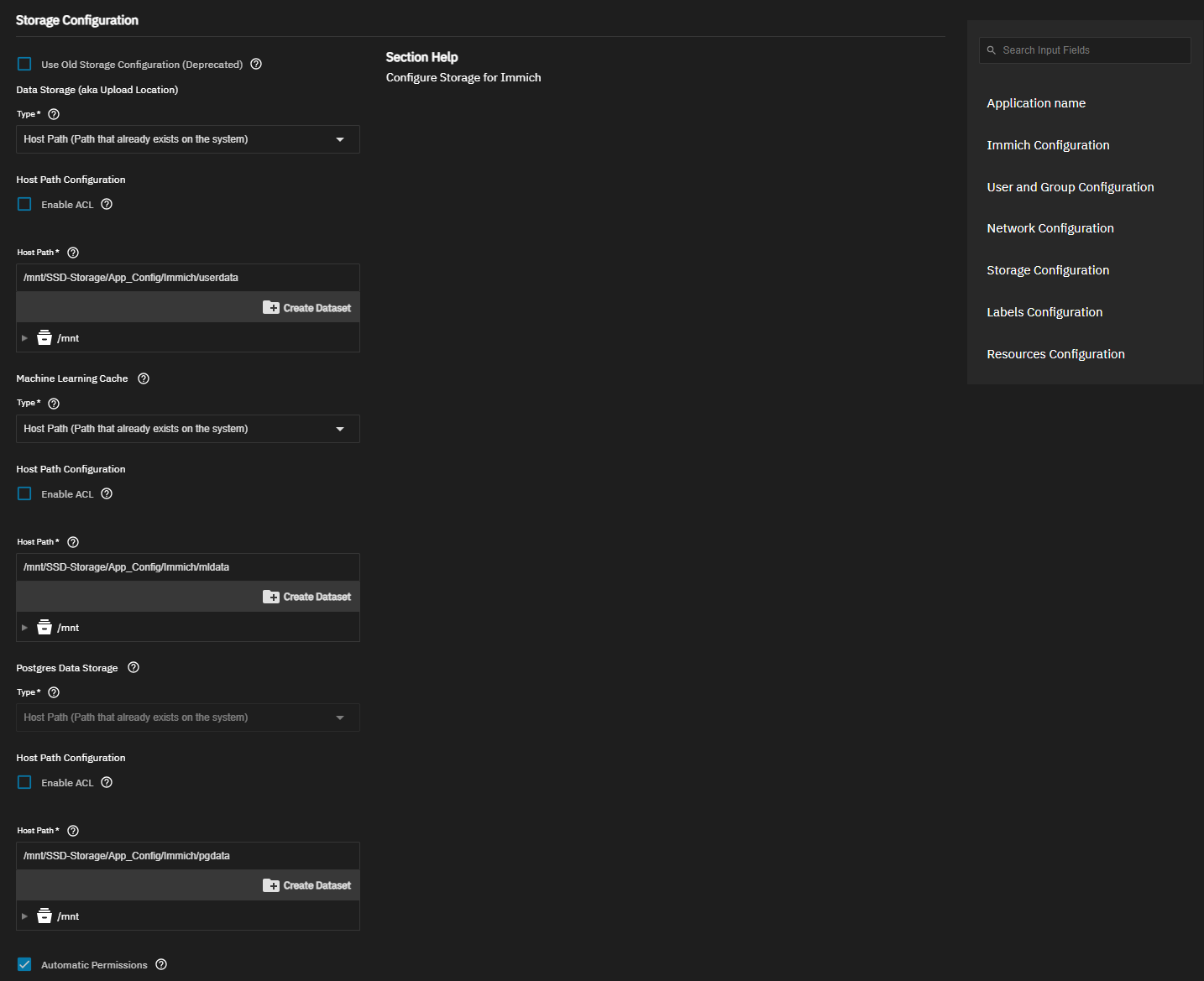

6 - When you have finished Rsyncing the datasets above into the new Userdata dataset, go to edit the app and deselect the Old Storage Configuration, and select the new Data Storage Host path to the new Userdata dataset.
7 - Leave the PGData and ML data unchanged. You want these to be outside of the Userdata dataset.

This is my new Storage config in case it helps with visualising the change.

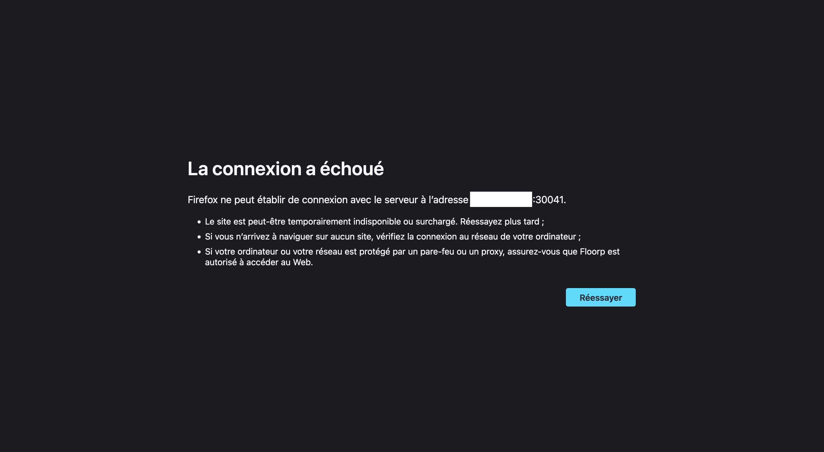

I did the update but i have this message now. Why that ?
EDIT : now it’s work :wink:

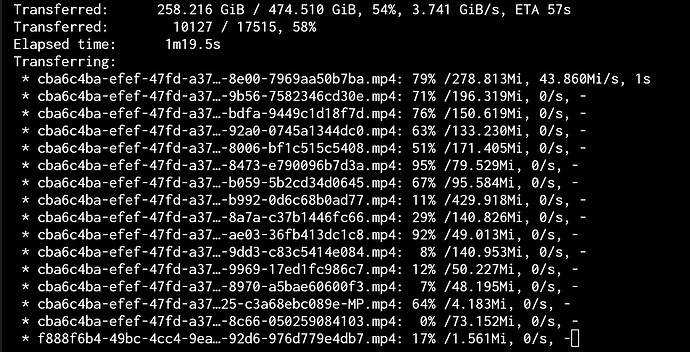

I’ve had a bunch of performance issues with rsync when trying to multi-thread for SSDs, so I updated your commands to use rclone instead:
rclone copy --progress --transfers 4 /mnt/<POOL_NAME>/Immich/backups/ /mnt/<POOL_NAME>/Immich/userdata/backups
rclone copy --progress --transfers 4 /mnt/<POOL_NAME>/Immich/library/ /mnt/<POOL_NAME>/Immich/userdata/library
rclone copy --progress --transfers 4 /mnt/<POOL_NAME>/Immich/profile/ /mnt/<POOL_NAME>/Immich/userdata/profile
rclone copy --progress --transfers 4 /mnt/<POOL_NAME>/Immich/thumbs/ /mnt/<POOL_NAME>/Immich/userdata/thumbs
rclone copy --progress --transfers 4 /mnt/<POOL_NAME>/Immich/upload/ /mnt/<POOL_NAME>/Immich/userdata/upload
rclone copy --progress --transfers 4 /mnt/<POOL_NAME>/Immich/video/ /mnt/<POOL_NAME>/Immich/userdata/encoded-video
Some of my directories were named differently to yours, so I changed them here too and simplified it to make modifications easier.
Change the thread count to whatever works for your system. I set it here as 4, but I used 16 threads on my system and got some pretty decent transfer speeds considering how small these files are:
