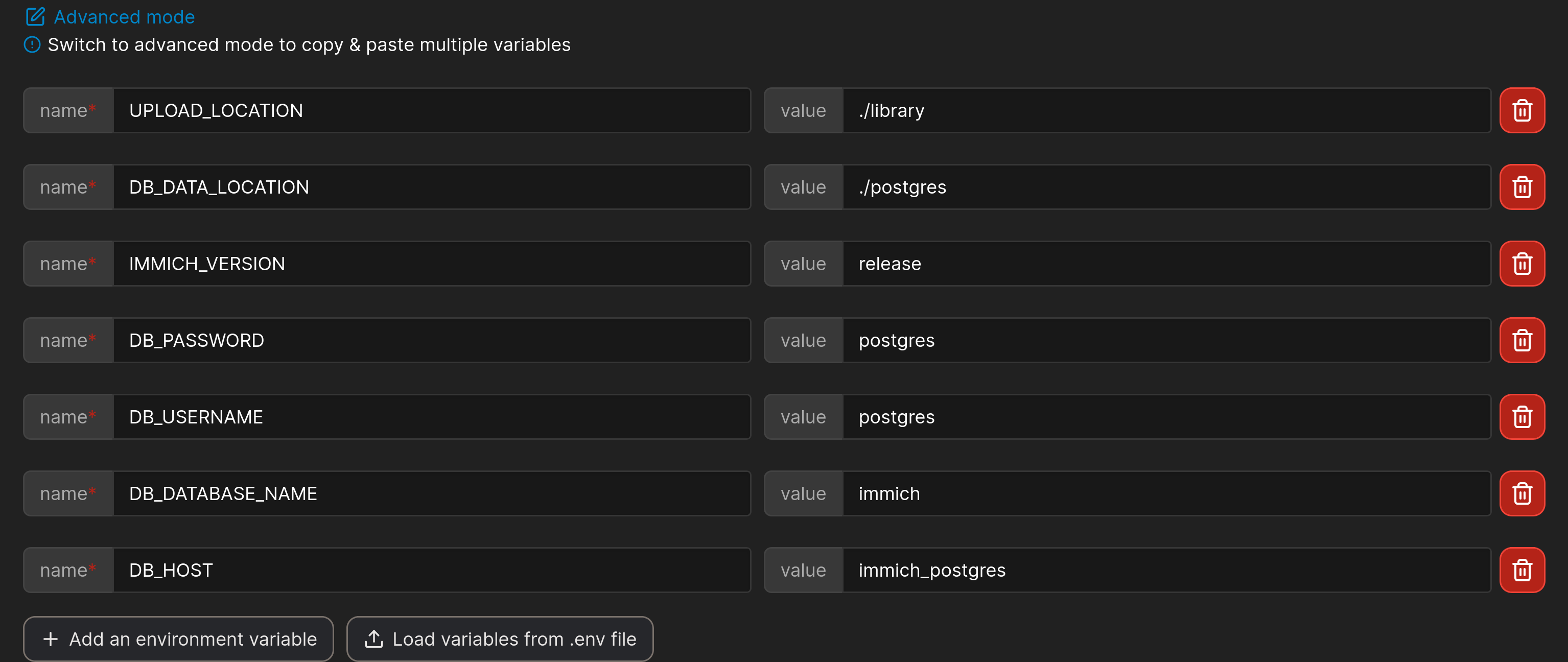

I run immich using Portainer. So I created a sample .env file with the following variables:
IMMICH_URL="http://192.168.0.13:2283" # Immich URL
IMMICH_API_KEY="MySecretKey" # Immich API Key
DB_USERNAME="postgres" # Postgress Database Username
DB_PASSWORD="postgres" # Postgres Database Password
DB_HOST="immich_postgres" # Postgres Host (IP address or hostname of the database)
DB_PORT="5432" # Postgres Port number (Default: 5432)
DB_DATABASE_NAME="immich" # Name of the database

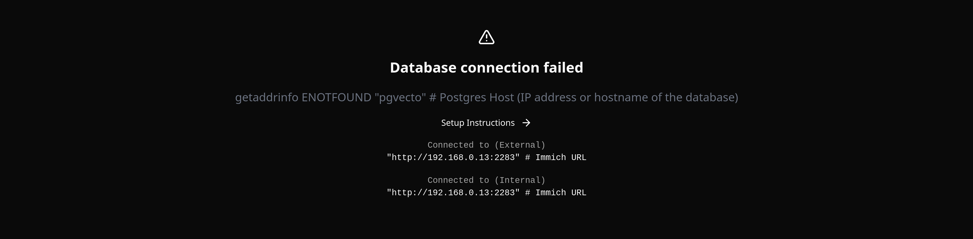

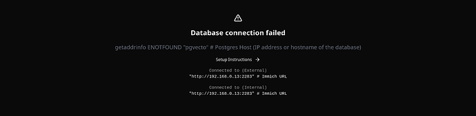

I get this error when I visit http://192.168.0.13:8001/ after following the portainer instructions GitHub - varun-raj/immich-power-tools: Power tools for organizing your immich library.

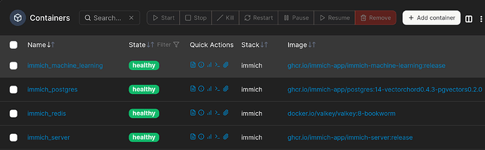

Ignore pgvecto on the image. I tried various host names. According to my immich variables in portainer the hostname should be immich_postgres:
That is also the name of the postgres database container:
I also attach my yml file.
