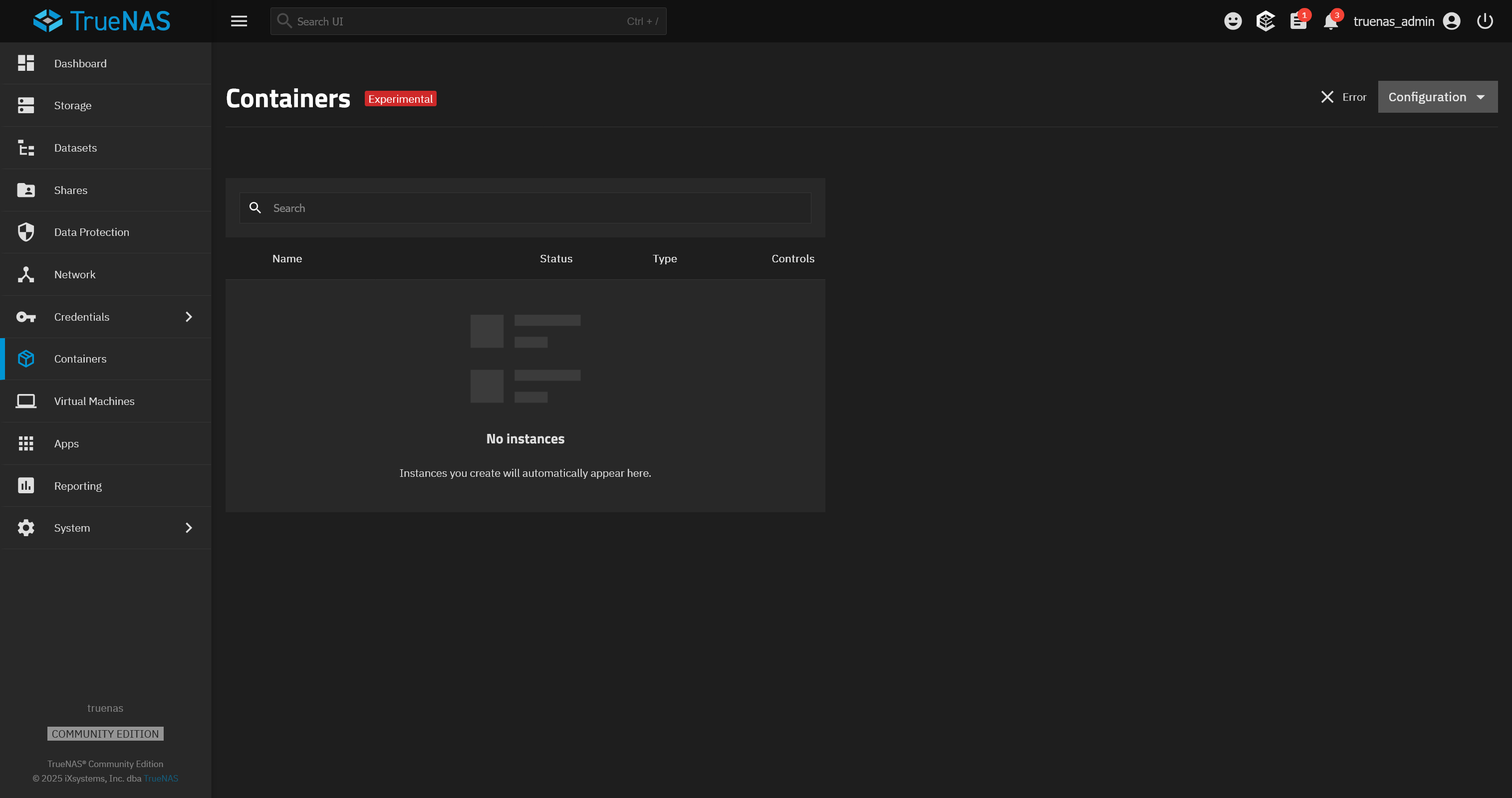

Eventually I updated to 25.04.2.1 (I skipped 25.04.2). After the update, the Instances UI (now “Containers”) does not list my container any longer and instead shows “Error” on the top right.

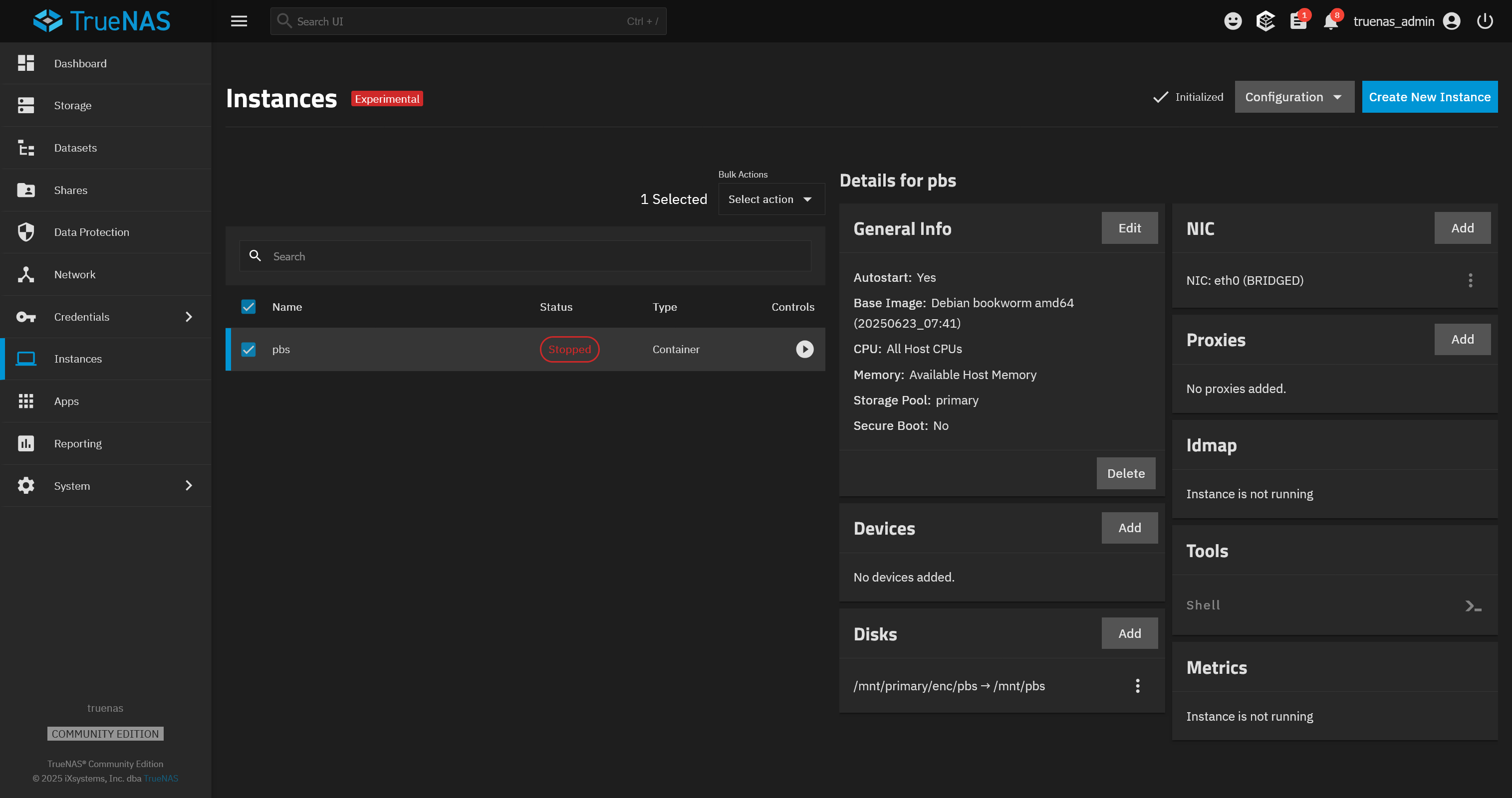

Here are screenshots from the UI before and after the update:
