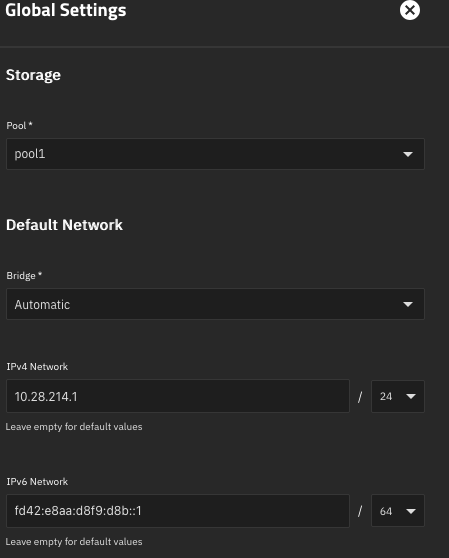

In this case, how have you setup the global settings:
Thanks but incus root disk is usually defined by the init process.
Sure, as Stephane pointed out there is a way around this but why has trueNAS not defined the default disk as the (obvious) root disk?
I still don’t know what you set-up as global settings…
If you’ve done everything right… then we start a bug-report or feature request.
Are you talking about the storage pool under global settings? That has nothing to do with the incus root device. This is to be found in the incus profile.
I’ll will do the bug-report and link it here for reference.
They should be related… the root device should be set-up on the pool (and probably in a dataset).

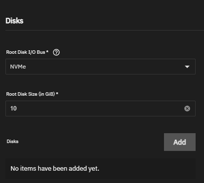

So, if the instance is setup via webUI, it would have a root device automatically created?
You could keep things as they are and just always pass --storage default when creating instances, but that may get a bit annoying
– (Incus launch fails: No root device could be found - #6 by stgraber - Incus - Linux Containers Forum)
Isn’t that essentially what the UI does by defining disks during VM creation?
