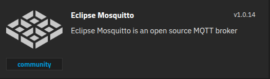

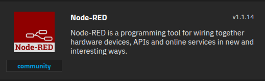

I have a simple docker compose which I want to use to install some software which listens to data on a USB port and presents it as MQTT messages.
I then want to process that MQTT data using mosquitto and/or node-red, both of which are available as official “community” TrueNAS apps:
